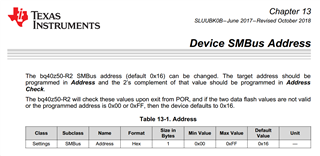

It is stated in the specification of BQ40Z50-R2 that the SMbus address can be changed。

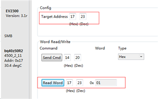

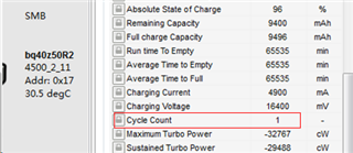

Read Cycle count from Advanced Comm SMB.

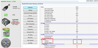

The SMBus address has been changed to 50,
and the address check is b0.
It is found that it cannot be read.
When the target address is changed to 16,
the correct value can be read.
