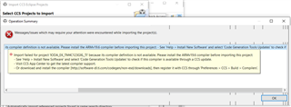

I am facing the following error while importing my project :
" See details below...
Import failed for project 'IODA_EK_TM4C123GXL_TI' because its compiler definition is not available. Please install the ARMv19.6 compiler before importing this project:
- See 'Help > Install New Software' and select 'Code Generation Tools Updates' to check if this compiler is available through a CCS update.
- Visit CCS App Center to get the latest compiler support.
- Or download and install the compiler [http://software-dl.ti.com/codegen/non-esd/downloads], then register it with CCS through 'Preferences > CCS > Build > Compilers'."
Or, even at the location given I wasn't able to find this compiler version.
What can I do ?
Thank you for your help,
Elisabeth
  • Hello Elisabeth,
    If you have a newer compiler like v20.x then the project should still be able to be imported. Can you see what the newest Arm compiler you have installed is? And if it is older than v19.6, just update to the latest Arm compiler CCS offers.
