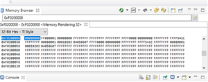

I am using halcogen
example_TI_Fee_Write_Read.c  to read and write data intto eeprom
my writing operation is fine and i can see the data in memory browser and when i use read function after write function i can see the same data in read buffer but the problem is when i use read function alone all what i got is 0 so what i have to do if i want to read the data from eeprom without rewriting  the data ??
all what i need is write the data for once then read it whetever i want
i will be waiting for help from all
have a good day

  • You can read the block from eeprom any time. You don't have to rewrite the block before reading it.
    I checked your screenshot. The block #1 in the EEPROM is a invalid block. This is why your read returns zero.
    Please comment out the TI_Fee_InvalidateBlock(BlockNumber) in your code, then try.
  • thank you very much for replying i tried it and all things is fine but i have another question how to select which adress to read and write?
  • for example if i want to read those different data because i could only write data to blockno 0x1 and read from but every time i read it just show me the last data i have been wrote .
    so can you inform me please how to select which block/adress to write and read and which ones is available to use
    The Data Block is used to define where the data within a Virtual Sector is mapped. When you write data to FEE, only block# and data source address are needed. If the block# exists in EEPROM, and the writing data is same as the data in EEPROM, the write operation will be ignored. If data is different, the block  header of block# and new data will be written to a new location, and marked as valid block. Another block# is marked as invalid block.
    When you read the block, the FEE API will the data from the valid block#.
    The # of blocks and block size should be defined before using them. Refer to the ti_fee_cfg.c for virtual sector definition, and block definition.
