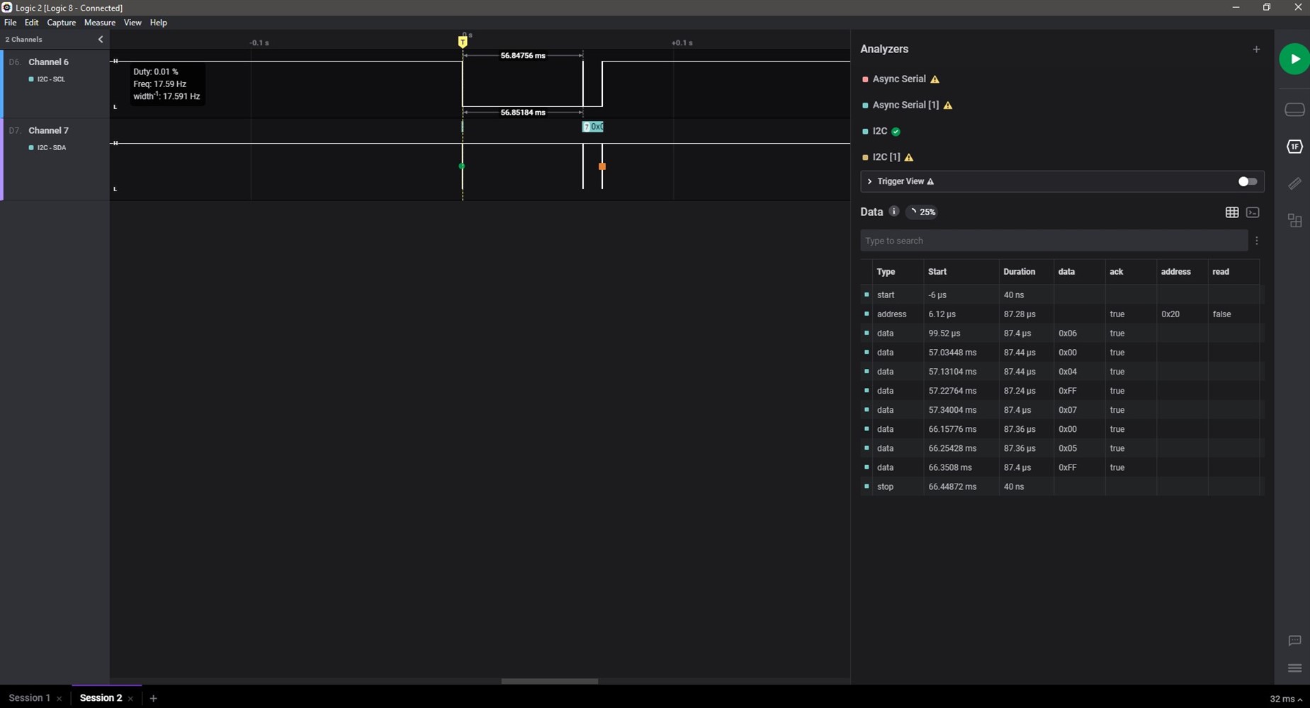

I am having issues with i2c transfers having gaps between bytes on both callback and blocking modes.
There are 8 ms gaps between parts of the transfer when using blocking calls.
I thought the internal driver would use interrupts so even if the task switches the bytes are sent properly.
I didn't have the issue with SPI or UART drivers when I was using them.
If I try it with a devkit example that only has a single task I have no issues. The transfer is not broken into parts.

Here is some captures of the i2c lines:
Custom board blocking i2c:
There is a large gap of 7.4 ms on the same transfer.
If I use callback mode it is even worse, there is a 50 ms delay in the middle:
If there is multiple transfers there is multiple cuts in the middle. These cuts are not between transfers they actually go in the middle of transfers.
Some transactions don't get cut but most do.
