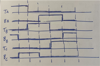

Hi all, my aim is to control a driver of a brushless motor by using 6 pins that come directly from 6 pins of my microcontroller (MSP432P401R), where 3 of them act as normal GPIO and represent the lower transistors (BA, BB, BC) and the other pins have the special function of PWM (TA,TB,TC) and share the same timer and port as well (P2.4, P2.5 and P2.6) respectively. The program is based on a FSM of 6 states and in each state there are 2 pins that stay HIGH and the rest stay LOW as it could be seen in the image above. The sequence is the one that appears in the image and when it arrives to the 6th state it starts over going to the 1rst state and so on. To sum up, TA, TB and TC are controlled using PWM and duty cycle is applied on them to take control of the speed of the motor and BA,BB and BC are normal GPIOs that could be HIGH or LOW depending on the state. My main problem is that I don't know how to switch between TA, TB and TC by applying PWM on one pin and disabling the PWM applied on another pin in the state before, like for example what happens then you reach the 3rd state and you should stop applying PWM to TA and start applying it on TB (hope it's clear). The code I wrote for this is the following one, but I know it has problems and if someone could help me understand what should I do and how to do it in a properly way, I would be really grateful!

    For your application, I am assuming you are looking for trapezoidal control, which involves PWM'ing the phases in a 6-state commutation table. I am not sure what you will be using for your gate driver, but assuming you are using a gate driver to control 6 external MOSFETS (one HS + LS for the three phases), you will need to ensure that you follow the commutation methods as described in trapezoidal control to PWM the HS + LS signals for the 3 phases accordingly.
    The three phases will either be:
    1) High side on (HS = PWM, LS = !PWM or low)
    2) Low side on (HS = low, LS = on)
    3) Floating (HS = LS = Hi-Z)
    I am not very familiar with the MSP432P401R, but we do have a MSP430 software example for 6x PWM trapezoidal control in this reference design.

    When you commutate the motor with just the PWMs, this is called open loop commutation and it is difficult to spin the motor unless if the rotor position is known. To detect the position, you can use Hall sensors (sensored trapezoidal) for digital feedback or you can calculate the BEMF zero-crossings of the floating phases to change to the next commuation state (sensorless trapezoidal). These methods are called closed-loop commutation.
    There are many ways to determine the BEMF zero crossing during commutation. You can use comparators to measure VCC/2 on the floating phases, feed the BEMF to ADCs on the MCU and integrate the floating phase BEMF and compare it to a known threshold, or you can measure the phase voltages and currents through ADCs and use a first-order differential equation to calculate the BEMF from the equivalent circuit.
    Check out the BOOSTXL-DRV832x firmware for the MSP430F5529. We have sensored and sensorless code available in that package. The sensorless code using BEMF integration to estimate the BEMF of the floating phases. We also have the DRV832XX EVM Sensorless Software User's Guide which describes in detail how to calculate the BEMF using the integration technique.
