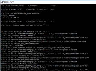

i am trying to connect the MSP_EXP432E01Y with an Azure IoT Hub to send and recieve messages. In a later setup i would like to expand this construction and use the CC3135 WiFi Boosterpack.
As a first step i tried to integrate the "simplesample_http" example from the SimpleLink MSP432E4 Azure IoT Plugin - 4.10.00.02 extension (https://dev.ti.com/tirex/explore/node?devtools=MSP-EXP432E401Y&node=ADiAEj8QIj0VQexSeqlw7Q__g-ygqY8__LATEST).  I added the connectionString as mentionend in the readme-file.

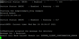

When i run the code and display the output in putty the following recieved:
Furthermore the azure portal shows no incoming (telemetry) messages occured:
Is there something else to configure (for example certs,...?)

  • In the following the output in putty with <logging enabled>:
    However, I still cannot find the solution to the problem.

  • Hello Dennis,
    if it helps the from HTTPClient_connect function returned error code -2021 means according to slneterr.h that the Function couldn't execute correctly.

  • I found out, that the script is running in another network. This is caused by some security settings of the used network. I have to adjust the proxy settings. Is it possible to do that with the MSP-432E401Y and if, where could I adjust this changes.
