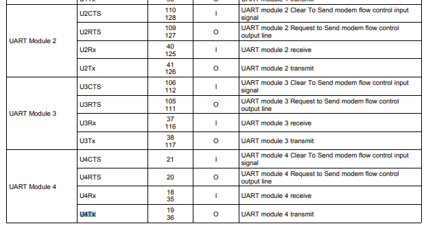

The MSP432E401Y has a pin-mux which can be used to change the pins used for some peripherals.
However, looking at the UARTs in Table 4-2. Pin Attributes of the datasheet I can't see any UARTs which allow the pin-mux to swap the RX and TX signals:
I presume you are asking due to a layout issue which has swapped the RX and TX signals on the PCB, and want to correct in software?
Thank you for your answer.
Exactly, that's a layout issue and I would like to avoid cutting traces and soldering wires to solve the problem.
