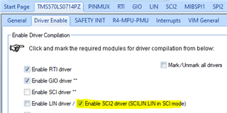

    I am still struggeling with the SCI Notification interrupt using the SCI2 RX signal.
    The RX signal of my sensor is now connected to PIN 94 (LIN RX).
    Until now, the sciNotification(sciBASE_t *sci, uint32 flags) function is not triggered by the RX interrupt (which is my intension)
    Could you please have a look on my CCS code and Hal Gen settings?
    (The settings in HAL GEN -> SCI2 -> SCI/LIN Global: was tested with RX int connected with High Level and tested with RX int NOT connected with High Level (as shown by you)) without success.
    Do you have an idea why sciNotification is not triggered?

  • Hello Simon,
    There is no problem for me to get SCI RX interrupt on my LS12x launchpad. I don't have HW board to test TMS570LS0714 PZ package at this moment.
