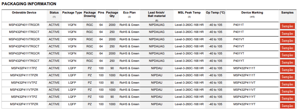

I'm in need of a higher temp version of the MSP432 (operation up to 105oC). The datasheet selector guide would seem to indicate that this is an option but I can't find it on ti.com.
Is this an option?

There is the MSP432P411xT, MSP432P401xT series. From MSP432P411xT, MSP432P401xT SimpleLink Mixed-Signal Microcontrollers datasheet (Rev. B):
