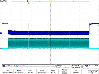

I am working for data transfer between two TMS570LC4357 controllers, both side MibSPI-1 connected with CS0, CLK, MISO[0], MOSI[0] and ENA pins. I am using the code to configure DMA from example. The data transfer is fine when I have tested with ECOUNT as 4 and FCOUNT as 4. As per my application requirement configured the DMA buffer transfer with ECOUNT as 94 and FCOUNT as 4. The transfer is initially OK, but after few transfers, the data started rolling. I have started checking with the SPI analyzer.
The CS insertion with 4X4 data is much clear and the CS was inserted regularly. With the bigger buffer transfer, the CS looks bit different, and would like to check what could be the possible issue.
The entire buffer looks like this.
Zoom in the first section (there are 2 first set of identical buffers)
Further zoom (each is of 4 words of 16 bit each)
 Zoom the large buffer (there are 90 words of 16 bit each)
In total 4+4+90+4+4+90+4+4+90+4+4+90 (total 98 x 4)
The CS is not uniform during the bigger buffer as below (Not sure why?)
The DMA configuration as below.

I have given enough delay for both CS and ENA pins before and after insertion.
The data is also simple array of UINT16 size.
Looking help to understand what could be the issue and how to solve.

  • Hello Chandra,
    From the code in your post, MibSPI1 TG0 has 98 buffers (start of TG1). But MibSPI RAM configuration is not consistent with the TG0 and TG1 defined in TGxCTRL register.
    Please use HALCogen to generate MibSPI code.

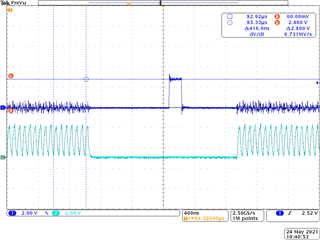

    Have a look below - 3 data packets of 98 X 4 data
    Zoom one packet
    Zoom one frame
    Zoom the frame do not have proper clock
    Improper clocking
    TMS570LC4357_MibSPI1_DMA_Master&Slave.zip
    Chandra
  • Hello Chandra,
    I saw the improper SPI clock in the last diagram.
    In your MibSPI configuration, the CSHOLD is set to 1 in both master side and slave side. So the CS pin should not to be deasserted between two buffer transfers (within one frame transfer). Why the CS is deasserted in your last diagram:
  • In slave side, if CSHOLD is disabled, the de-assertation of CS signal is to trigger copying the received data to RXRAM. If CSHOLD is set,  MibSPI does not wait for the SPICS's de-assertation for copying the received data to the receive RAM. My understanding is that the SPICS toggle between the buffer transfer should not affect the data reception in SPI slave.

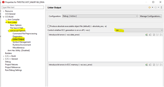

    The example project includes two linker cmd files: HL_sys_link.cmd and HL_sys_link_ecc.cmd.
    1. If HL_sys_link.cmd is used (exclude other link cmd from compiling), please check the "Auto ECC generation" when loading the program to flash
    2.  If HL_sys_link_ecc.cmd is used (exclude other link cmd from compiling), please uncheck "Auto ECC generation" and select "NONE" for Flash Verification Settings. To enable Linker ECC generation, please change the project linker output setting:
    I just tested the project, it works without any issue.

    Chandra
  • With your updated code, the MibSPI CS issue can be produced using just one MCU (MibSPI1--MibSPI3), right?
  • The CS is clean on a single MCU. I did not see issue. But still I see frame loss, with 25 MHz clock set and task delay changed to 2 tick for both TX and RX task.
    Chandra
  • Hi Wang,
    Can you please have a look in to the issue, and answer my questions on 12 May.
    Thanks. Chandra
  • I will run the test on LC43 Launchpad.
  • Hi Wang, I was checking the signals on the scope instead of the logic probe. I see the level of CS signal is removed it is 2.8V and active 0.78V with some noise could be because of scope or wires. This capture was taken with clock configured to 15 MHz. I see that the frame overlap being low, when the clock frequency is low and increasing with higher frequency. Similarly, the frame overlap is also increasing if I am decreasing the delay of the task, means more frequent transmission of data.
    I think the noise is making the logic probe catching unwanted CS signals. I have a 10K pull-up resistor on the CS line.
    Is it possible for you to get one more LC43 launchpad and try my code on two different boards? I hope you can get it quickly.
    My aim is to send and receive data for every 1mSec.
    Eagerly waiting for your reply.
    Chandra
  • Hi Wang, wish you are doing good and safe. I am looking for a reply from you.
    I have made few more testing. With 10 MHz clock and 100 ticks task delay, the data transfer is stable.
    I have changed the clock to 20 MHz and see very few times the frame loss and the data stable again.
    I have changed the task delay to 10 ticks. The frame loss is frequent than earlier and also the data offset present. That means at the RX buffer the first data element is 0x6A80 instead of 0x6A00. with this offset the data transfer goes on.
    I do not have any clue how I can put back the right data set again.
    I have removed the load on CPU by disabling the FOC function execution.
    Please makeup some time to answer my questions, below again.
    1.When the BTC interrupt was hit, I am reconfiguring the DMA to trigger TX. May be this is not correct. Please let me know, what is the proper method.
    2.To synchronize the TX and RX between both the channels I am using buffer mode as 5 (Wait until TX full). Please note that my communication is between two different controllers, and I need to create mirror image of global data buffer with least possible latency. Shall I need to use different buffer mode for proper sync.
    3.What is the highest clock speed can be used practically with MibSPI.
    4.I am using motor control FOC in the ETPWM interrupt, which was configured for 25 KHz cycle time.
     Chandra
  • Hi, Can some one reply to my above questions?
    Chandra
  • Hi, I am still waiting for a reply and some help.
    Chandra
