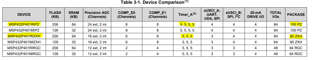

It is necessary to make a firmware using "Energia IDE" on a custom board with MSP432P401RIZXH.
Used the standard example Blink.
When using "delay(250)", everything works, but if I use a time that is not a multiple of 250, then the processor freezes on the "delay()" command.
I suspect that the "switchToTimerA()" function inside the "delay401R()" function in the "wiring.c" file is to blame.
It uses the "energiaClockTimer" with TIMER_A3 structure which is not found in the MSP432P401RIZXH.
Everything works fine on the MSP-EXP432P401R board.
How to fix it?
