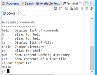

      First of all, I'm not a USB expert. So my help on the USB debug will be limited. I may need to forward your question to our USB expert. With that said, I ran your project as is without any modification and I can see the input.txt created and if I do a 'cat' command I'm able to see the "Hello" in the file. See below.
  • Thank You for help, What you have tested is USB HOST MSC Example that works for me also, i provide for the reference purpose of the merged code named enet_tcpecho_server, which was earlier shared in this discussion. Hope to have soon reply from USB expert
