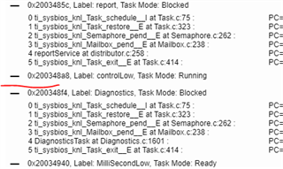

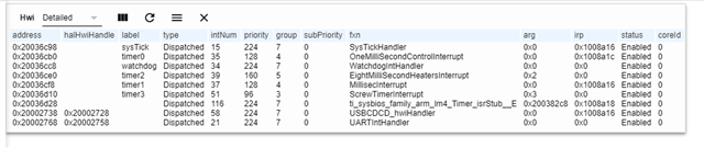

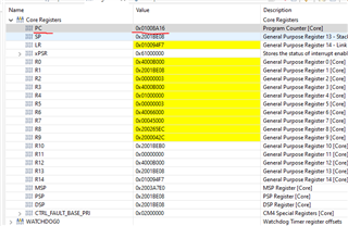

recently I see that the program counter (and the IRP for most of the interrupts) goes beyond 0x100,000  (e.g 0x108a16).

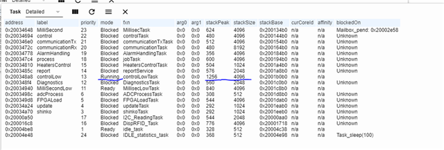

I do not see any stress on the task stacks, no exception, and, actually - the upper priority tasks are running normally. one of the tasks does not have a call stack and goes to this pseudo-address when it gets the CPU.

  • recently I see that the program counter (and the IRP for most of the interrupts) goes beyond 0x100,000
    Your screenshot of the registers shows the PC value of 0x1008a16. That address is actually inside the On-chip ROM of the device, and so is a valid address if your program calls ROM_ (or possibly MAP_) functions in TivaWare.
    Note that the data sheet current shows an incorrect start address for the on-chip ROM. See CCS/EK-TM4C1294XL: Memory Map Prevented reading 0X01009B7C
    Does the task stop running correctly, or it just that when you sample the call stack when running under the debugger that you see the code in a call to a function in the on-chip ROM?
    There is no symbolic information to the CCS debugger for the contents of the on-chip ROM, and without testing not sure if the debugger or ROV will be able to show a call stack with no symbolic information.

    the code stops running correctly - the task that is pointing to this address is in eternal loop. all tasks above it are running correctly, including the interrupts.
