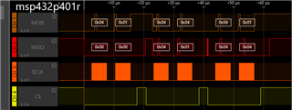

I am communicating with NCV7708 double hex driver via SPI with msp432p401r uC.
According to NCV7708 datasheet when i write to ncv chip i should simultaneously read written data from chip.
But unfortunately what i write doesnot simultaneously comes at MISO. Alternatively it comes at next clock cycles which i send for the next command.

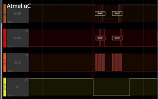

Previously in our old products we have used Atmel XMEGA256A3U uC with ncv chip and there what we write comes simultaneously on MISO as written in ncv datasheet.
Can someone please guide me what i am doing wrong in my code for msp432p401r spi communication.I have attached my code file and spi waveforms.
Many thanks,

uint8_t spi_write_and_read_byte(const uint8_t byte) {
    /*! Wait until USCI_B0 TX buffer is ready. */
    while (!(EUSCI_B0->IFG & EUSCI_B_IFG_TXIFG))
    /*! Transmit characters. */
    EUSCI_B0->TXBUF = byte;
    /*! Wait till a character is received (this wait is necessary). */
    while (!(EUSCI_B0->IFG & EUSCI_B_IFG_RXIFG))
    return EUSCI_B0->RXBUF;
void write_input_data(const uint16_t value) {
    /*! Select Device. */
    NCV7708F_BSP_CS_IO_PORT->OUT &= (~NCV7708F_BSP_CS_IO_PIN);    /*! P5.7 = low */
    tx_byte_0 = value & 0x00FF;
    tx_byte_1 = (value & 0xFF00) >> 8;
    /*! Send Byte 0. */
    rx_byte_0 = spi_write_and_read_byte(tx_byte_0);
    /*! Send Byte 1. */
    rx_byte_1 = spi_write_and_read_byte(tx_byte_1);
    rx_16  = (uint16_t) (rx_byte_1 << 8) | rx_byte_0;
    /*! Un-select Device. */
    NCV7708F_BSP_CS_IO_PORT->OUT |= (NCV7708F_BSP_CS_IO_PIN);     /*! P5.7 = High */
