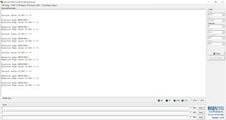

I'm working with the TM4C1294XL evaluation board. I'm connecting the waveform generator to the PD0 of the board. So basically my task is to calculate the turn-on time of the received duty cycle. For doing so, PD0 is configured as follows

Now the point is, in the ISR I want to detect when exactly the rising edge or falling edge arrives so that I can capture the timer counter value exactly when the falling edge arrives. Initially, I thought that if zero received at the pin PD0 then the falling edge is received and if one is received then it should be the rising edge but I'm not sure about this.The which I have written is as follows,

Also, I'm attaching the output where some random 0 snd 1's are received!.
So I wanted to be sure in the ISR that whether falling or rising edge received.
Any help or suggestion will be really appreciated!

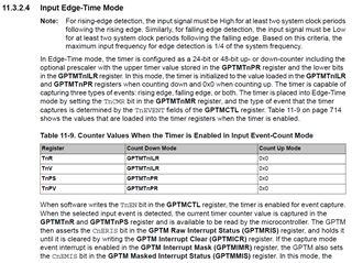

      I think your choice of using GPIO to measure time of an input is wrong. You should use the timer module in Edge Time mode instead. Please refer to timer module Input Edge-Time mode for detail.
    There is an example in C:\ti\TivaWare_C_Series-2.2.0.295\examples\boards\ek-tm4c1294xl\timer_edge_capture doing duty cycle measurement. I suggest you reference the example. This example uses two timer to measure any duty cycle. But you may be able to use just one timer if your duty cycle is longer than the time it takes the processor to enter interrupt. In another word, in your application, if the duty cycle is long enough you may be able to work with just one timer.  Using GPIO to measure time is not the right solution in my opinion.

  • I have tried the example which you have suggested above. In my project, I'm going to use only one pin which will be configured as a timer(PD0). So, I wanted to know can I detect both the edges in the one Timer0AIntHandler ISR if yes then how to do the same??
    I'm trying this for a long time so, any help will be really appreciated!!
  • So, I wanted to know can I detect both the edges in the one Timer0AIntHandler ISR if yes then how to do the same
    To detect both edges just specify both edges like below example.
    TimerControlEvent(TIMER0_BASE, TIMER_A, TIMER_EVENT_BOTH_EDGES);
    Use two pins is more reliable for measuring any duty cycles and I highly recommend you do with two pins if possible.  If you really just want to use one pin then each time you detect an edge, an interrupt is generated. In the ISR you will need to first read the pin state. If the pin is high then it means you have a rise edge. Save the current timer value (by calling TimerValueGet()) and save to a variable called rise_edge. Next time when you get an interrupt, it must be a falling edge and save the current counter value into a variable called fall_edge. When you take the difference ( fall_edge - rise_edge), it becomes your duty cycle width.
