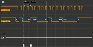

I have a logic analyzer on pin B2 and B3, which are SCL0 and SDA0 on the TM4c123GXL Board.
GND is connected and the logic analyzer is set up properly.  (tested on a different device)
I would expect my code to repeatedly transmit data, however my logic analyzer shows me that absolutely nothing happens.
Is something wrong with my code?
Thank you
  • I have a logic analyzer on pin B2 and B3, which are SCL0 and SDA0 on the TM4c123GXL Board
    In the posted code I can't see any calls to set the B2 and B3 pins to be controlled by the I2C0 peripheral. While Table 10-2. GPIO Pins and Alternate Functions (64LQFP) in the TM4C123GH6PM datasheet shows PB2 and PB3 default to the pin mux for I2C0SCL and I2C0SDA, TivaWare_C_Series-2.2.0.295/examples/peripherals/i2c/master_slave_loopback.c shows the following calls be made to configure B2 and B3 for I2C, as well as the call to SysCtlPeripheralEnable() for the I2C0 peripheral:
        // The I2C0 peripheral must be enabled before use.
        SysCtlPeripheralEnable(SYSCTL_PERIPH_I2C0);
        // For this example I2C0 is used with PortB[3:2].  The actual port and
        // pins used may be different on your part, consult the data sheet for
        // more information.  GPIO port B needs to be enabled so these pins can
        // be used.
        // TODO: change this to whichever GPIO port you are using.
        SysCtlPeripheralEnable(SYSCTL_PERIPH_GPIOB);
        // Configure the pin muxing for I2C0 functions on port B2 and B3.
        // This step is not necessary if your part does not support pin muxing.
        // TODO: change this to select the port/pin you are using.
        GPIOPinConfigure(GPIO_PB2_I2C0SCL);
        GPIOPinConfigure(GPIO_PB3_I2C0SDA);
        // Select the I2C function for these pins.  This function will also
        // configure the GPIO pins pins for I2C operation, setting them to
        // open-drain operation with weak pull-ups.  Consult the data sheet
        // to see which functions are allocated per pin.
        GPIOPinTypeI2CSCL(GPIO_PORTB_BASE, GPIO_PIN_2);
        GPIOPinTypeI2C(GPIO_PORTB_BASE, GPIO_PIN_3);
    Can you try adding the above calls from the TivaWare example to your code to see if I2C activity is generated on the pins?
    Also assume that the hardware has pull-up resistors on the SCL and SDA signals.
      Chester is right that you didn't configure the I2C pins. There are several examples in C:\ti\TivaWare_C_Series-2.2.0.295\examples\peripherals\i2c that you reference as well as a complete CCS project in C:\ti\TivaWare_C_Series-2.2.0.295\examples\boards\ek-tm4c123gxl-boostxl-senshub\humidity_sht21_simple that you can import into CCS and run it right away.

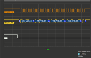

  • I stumbled upon another thing, which I don't know how to solve:
    I'm trying to send more then one byte of information per transaction.
    Right now I'm able to send one byte (first, the address byte, then the information byte) but I need to send more than that (address, command and two values)
    I tried the following, without success:

    I removed SendData from the Loop, now there is only one transmission upon start of the programm. I used PF2 to trigger my logic analyzer. I tried the BURST_MODE command but as stated in the code, it will still only send one byte. Namely, the last one that I put before I end the burst mode.
    I based my code upon the example of Charles. (humidity_sht21_simple) Burst mode is used there in a pretty similar way (I think) but only for receiving. Maybe thats the important difference.
    So, my question is, has someone and idea or can point me in the right direction? I didn't found examples where Burst Mode is used for transmitting and the driver lib documentation does not go into much detail about this.
    Thank you
    Lucas

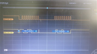

  • Hello Ralph,
    thank you for taking the time.
    Unfortunately, this did not resolve the issue, but it produced interesting results.
    First off, sorry for the bad quality. I took the photos from my phone. The computer that the logic analyzer is connected to has no connection to the internet so I'm unable to transfer screenshots. (usb stick does not work for other reasons)
    This first picture shows the outcome of the code you suggested with a slave connected. As you see, the data is acknowledged, but only the address (0x4C in this case) and the first byte 'H' is sent. The SCL line is not released for another at least 200ms, where the scope of my analyzer ends. Till then, nothing else happens.
    I did notice though, that the byte 'H' is the first byte that is to be sent in the code. Until now, it was always the last byte that i put before the _FINISH command that was sent. So in this case I would have expected it to be address and the 'P' byte.
    And without the double  while(!I2CMasterBusBusy(I2C1_BASE)){}  , that will still happen. So that problem is fixed.

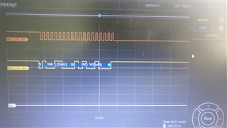

    Without a Slave connected
    Second picture shows the same code, but without a slave connected. Data is not acknowledged but SCL line still not released. So, without a slave connected, we have to assume that it's the tm4c123 that keeps SCL low, right?
    Lucas

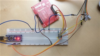

  • Hello Lucas,
    I was not able to replicate the behavior you described without a slave connected. I am wondering if there might be a hardware issue going on here. What is the value of the pull-up resistors you are using for your board? Are the pull-ups still attached to the I2C bus when you disconnect the slave?
    Another point I'd be curious about... I know ultimately you want to use Burst Send, but can you try using I2C_MASTER_CMD_SINGLE_SEND and see if that changes your results at all?

    Slaveless Setup:
    In this setup there is no slave connected. The brown lines are used to trigger the analyzer. The orange (SCL) and yellow (SDA) lines connect the LaunchPad to my logic analyzer. You can probably see the pullup resistors too. So yes, even without a slave, the pullups are connected. I use 5 kOhm resistors. I also tried 2.8 k and 8.9 k. All produce the same result on my logic analyzer:
    As we see, only one byte (the COMMAND byte 0x21, which is the first byte I want to transmit) is transmitted (apart from the address of course)
    Bytes are obviously not acknowledged. SCL is held low after the transaction (must be the LaunchPad since no other device apart from the logic analyzer is connected)
    Setup with Slave:
    As you can probably see, the slave is an arduino nano. I did this because the actual dcdc converter is embedded on a pretty messy pcb. To make it easier for you to check my setup, I chose to use this. However, I tested the abovementioned code on the arduino AND on the mentioned dcdc converter and got the exact same result:
    You can see the console on the right. The exclamation mark in the console indicates that the COMMAND 0x21 was received by the slave. But again, ONLY the exclamation mark, as the logic analyzer confirms.
    Bytes are acknowledged, SCL is again, held low for the rest of the recording duration of my analyzer.
    As I said, same result with the actual slave and the arduino.

    This is very similar to the first code, I just removed all the
    while (I2CMasterBusBusy(I2C1_BASE))
    lines,
    which produces the following result:
    We still only see one byte of information but this time it is not the first one that is to be sent on the code (0x21) but the last one (0x23)
    Also, SCL is released after the transaction.

    I use SINGLE_SEND in this example to send the COMMAND byte in the first transaction and the VALUE_1 byte in the second transaction.
    And as you can see, this works.
    ADDRESS / COMMAND and ADDRESS / VALUE_1
    A single transaction works too. Even three transactions work, but that wouldn't fit on my screen.

    And i received thw following result:
    This is exactly what I need! Tried this with the actual slave and was able to send the command which set it to the correct output voltage. This leads me to believe that my hardware setup musst be correct and my problem is only software-related.
