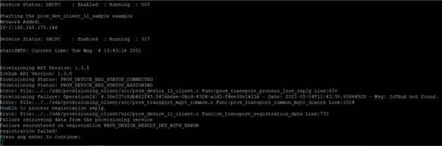

i have problems to run the "prov_dev_client_ll_sample" - example.
I followed the instructions in the readme file:
- generated test certificates (followed the instructions in the referenced manual)
- updated id_scope
- updated common_name
- Added enrollment
In Azure:
- IoT Hub/Certificate
- IoT Hub/IoT-Device
- Ennrollments:
The output is:
Through my troubleshooting I am convinced that the certificates, id_scope, common_name and the enrollment are working. (Otherwise further Error)
But it makes no difference in the console when I delete the root-ca certificate in the IoT Hub.
In other threads they mentioned it could be a problem if the time isn`t set correctly.
=> I am in GMT+02
Therefore the time in the console is e.g. 7:33 my time in azure is 9.33!
Could you help me to find the problem / how to solve it.
