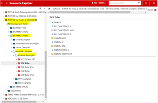

      We don't have an Ethernet example that uses semaphore or event to synchronize between tasks. For Ethernet only examples, you can download from Resource Explorer from within CCS.
