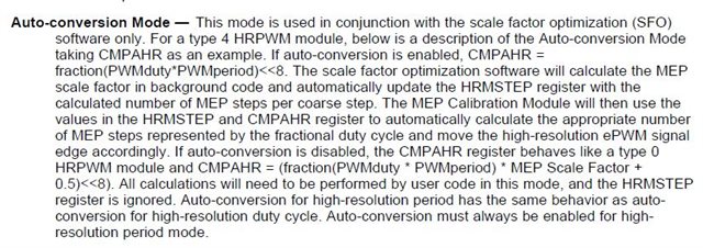

  • Hi Nima,
    In my opinion it is not much easier. I have looked through some examples using driverlib, ones that are slightly more complicated like digital controllers I need, and I am lost before I even spend a minute looking at it. There are functions all over the place with arguments all over the place. With the examples I have been using with direct register access they have been very easy to understand and quick looks in the technical manual tell me what I need to set certain bits as if I want to slightly change the functions of the modules.
    I believe the main error I have in this example, is using the HRPWM module. There are none that I can find which use the HRPWM module AND the digital controller library. So it's hard to understand how I can use a controller output to modulate the HRPWM Module. That part is missing from my code. It is below, using my "flyback_command" in place of "dutyFine" in the examples.
    CMPA_reg_val = ((long)flyback_command * EPwm1Regs.TBPRD)>>15;
    CMPB_reg_val = ((long)flyback_command * EPwm1Regs.TBPRD)>>15;
    temp = ((long)flyback_command * EPwm1Regs.TBPRD) ;
    temp1 = ((long)flyback_command * EPwm1Regs.TBPRD) ;
    temp = temp - ((long)CMPA_reg_val<<15);
    temp1 = temp1 - ((long)CMPB_reg_val<<15);
    // Shift Autoconversions 1-bit left
    CMPAHR_reg_val = temp<<1; // convert to Q16
    CMPBHR_reg_val = temp<<1; // convert to Q16
    // 32 bit write to CMPA:CMPAHR
    EPwm1Regs.CMPA.all = ((long)CMPA_reg_val)<<16 |
    CMPAHR_reg_val; // loses lower 8-bits
    But CMPA, CMPAHR, CMPB, CMPBHR are all zero. I am unsure whether the type-casting and shifting is done properly. I clamp the output of my DCL controller from 0.0 to 0.25 to represent a maximum duty cycle of 25%. The example I have been referring to uses dutyFine as an unsigned 16-bit integer rather than a float, and cast that to a long.
    Is that where I am going wrong? Am I shifting everything out of the register effectively making it equal to zero?
    Joel

    If auto-conversion feature of HRPWM module is enabled then you can actually directly program all the 32-bits of CMPA register (both CMPA and CMPAHR) in one go.
    For example, if "duty" in floating point and "time period" is the period of your PWM outputs then you can program by converting it to Q16 Fixed point format like below:
    HWREG(EPWM1_BASE + HRPWM_O_CMPA) = (uint32_t)((duty*(float32_t)time_period) * (float32_t)((uint32_t)1 << 16) + 0.5f);
    I would suggest you to review the configDuty() function inside device_loopback_example() available in C2000Ware directory: C2000Ware_3_04_00_00\examples\demos\hrcap_hrpwm_data_transfer\device_loopback
    Although it's a driverlib based example, but reviewing it would help you to understand how to program the HRPWM registers to update the duty etc.
    If my reply answers your question please click on "This resolved my issue" button located at the bottom of my post.
    Himanshu

  • Hi Himanshu,
    // Duty cycle command should be a volatile float32_t, and time period an unsigned 16-bit integer
    EPwm1Regs.CMPA.all = (uint32_t)((flyback_command*(float32_t)FLY_PERIOD) * (float32_t)((uint32_t)1 << 16) + 0.5f);
    I added the above code. My duty cycle command was 0.05, 5%. I am getting this okay in the CMPA register, it says 9 which is about 5% of my 1MHz time period.
    However, the CMPAHR register has value of 62208 in the register... I assume that this is too large?

    Regarding the CMPAHR register, only the UPPER 8-bits contain the high-resolution portion (most significant 8-bits). Look at the register description in the device TRM. Also if the auto-conversion mode is enabled then the CMPAHR just needs to be populated with fractional duty with Q16 format (as taken care in my earlier shared equation) and the hardware will automatically translate this into number of MEP steps with the help of SFO based calibration. See the below description in TRM, I would highly recommend you to completely go through the TRM chapter to improve your understanding of these modules:

    Actually you are getting the right CMPAHR value (evident as you are getting the right duty) but the way you are interpreting it is incorrect. That's what I was trying to suggest in my last reply, the way you need to interpret the CMPAHR value is different when the auto-conversion mode is enabled. Take some time to go through the documentation for auto-conversion mode that I pointed in my last reply, that should help to make things clear.

    I have completely followed this whole way your point. My issue remains. I have got the auto-conversion mode ENABLED.
    I have used the equation that you gave me, and still, the value in CMPAHR register is not correct.
    Even though I have used the exact same equation that you suggested that I use for when autoconversion is enabled.
    I have performed the shifting and a "single 32-bit write" which SHOULD write the value to both the CMPA and CMPAHR registers, as far as I know.
    Obviously, I must perform another shift or something which represents the value correctly - but the equation you have gave me is nothing like the one given in the technical manual, so I cannot tell what I am doing wrong.
    I will attempt to use the equations in the technical manual rather than the ones provided by yourself in a previous reply, since they are quite different.

  • Issue now is with C2000, does not recognise such a function as "frac(...)".
    = frac (PWMDuty*PWMperiod<<8).
    How do we seperate the fractional part of the multiplication in code?
    I am not an expert in coding. I understand frac() is not a function supported by TI C2000 but I would expect instead the technical manual would actually show you how to perform the frac conversion rather than just put frac().

  • You can actually use the fracf32() intrinsic on C2000 by enabling FPU32 option in your compiler settings, refer to the intrinsics section in the C2000 compiler user guide for more details.
    You do not need to separate out the fractional part if you make use of the equation that I suggested because it treats the input duty as floating point in the Q16 format so it can be directly written as-it-is to the CMPA register if the auto-conversion mode is enabled. This really helps to speed up the things which the original intention of adding auto-conversion mode. But you can of course compute the CMPA and CMPAHR values separately and write them individually if that seems easier to you, this is also absolutely correct.
