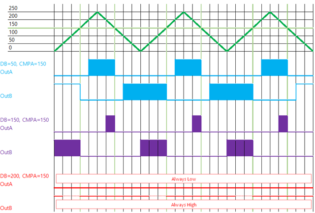

I have a question about ePWM's Deadband.
PWM Counter Mode uses Up/Down.
If the deadband is longer than the time from Up to Down of CMPA, do OutA and OutB always maintain Low and High outputs?
I'm not very good at English, so I'm not sure if the question is correct.
So I drew a chart.
Is the chart I drew correct?
Thank you for checking.
Additional question.
TBCTR became Zero as it counted down.
However, when the FED Deadband value is too large and it is not finished yet, is the FED value initialized?
Or does it affect the next cycle (TBCTR=Count Up) until the end of the FED value?
  • Hi Bae Su-min,
    Your diagram looks correct for the first two set of outputs when RED/FED=50 and RED/FED=150.
    For the case when RED/FED is 200, EPWMA output is correct, the waveform will always be low. However, EPWMB output will have a 20% duty cycle. The value does get delayed onto the next cycle so it will require 150 from the current cycle (starting from the CMPA Down event) and then 50 from the next cycle. It will be high from 50-150 (until the CMPA UP event). Please let me know if a figure will help.
    I answered this in the first part but it will affect the next cycle until the end of the FED value.
    Marlyn
