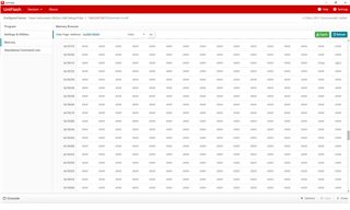

  • Hi Vamsi Gudivada,
    Sorry, forget about the F28004x, we just tested it ourselves.
    Once again, the customer is using F28075. The results of the Memory Browser are attached below. Some of the values are "0000", but basically it seems to be readable.
    O.H

  • Hi O.H,
    Could you share the screenshots for DCSM OTP content (for both zones)?
    Thanks and regards,
    Vamsi
    The contents of Zone 1 (= 0x78000 - 0x781F0) and Zone 2 (0x78200 - 0x783F0) are attached below.
    (Are the areas to be captured correct...?)
    O.H

  • OH,
    Just to summarize:  Data got programmed in to OTP as needed (in both Uniflash and C2000-GANG cases).  C2000-GANG is able to verify it successfully.  But Uniflash failed to verify that.  And the only field that is programmed in the DCSM OTP is Z2-BOOTCTRL.
    Did I get that correct?
    Please ask for the OTP dump.
    Also, can they send the file through which they assigned value to the Z2-BOOTCTRL?
    Thanks and regards,
    Vamsi
  • OH,
    As you can see, this is not a flash program error.  This is a read error.
    I discussed this with our CCS team.  Gel file's memory map defined the OTP space in the data page.  Hence, the memory map is not allowing the reads at the failing OTP address on the Program page.  To avoid this, you can suggest the customer to map the OTP data to data page in the linker cmd file and see if that helps.
    Thanks and regards,
    Vamsi
    Sorry for the late reply. And thanks for the support.
    Yes. You are right.
    Do you want me to run Memory Browser's Export and extract "The contents of Zone 1 (= 0x78000 - 0x781F0) and Zone 2 (0x78200 - 0x783F0)" instead of a screenshot?  If the problem persists after implementing the workaround, I would like to ask the customer for help.
    The file uses the previous "gpio_toggle_cpu01_change.hex" above. The first two lines of the file contain the addition of Z2-BOOTCTRL.
    I have asked you to change the linker command file. I will let you know the result later.
    Let me confirm the above explanation: I have confirmed that Zone 2 (0x78200 - 0x783F0) is defined in the data area in the Gel file (f28075.gel). I confirmed that nothing is defined in the default settings of the linker. However, from the Uniflash Memory Browser, I was able to read the OTP even though its contents were written.
    Could you please provide additional explanation as to why they are able to read from the Memory Borwser, but not allowed to read in Verify?
    1. Difference between C2000-GANG and UniFlash VerifyImage (Is there any compatibility between C2000-GANG Verify and UniFlash Verify?)
    2. The difference between "VerifyImage" and "Verify Flash after Program" in the Download Settings of Uniflash.
    Also, could you tell me about the above question?
    1. The simple interpretation is that the algorithm of Verify is different? Or does it mean that the Flash content can be Verified because the target configuration file is not used (i.e. Gel file is not used) in C2000-GANG?
    2. Does this mean that when the "Load image", Uniflash is automatically informed that Zone 2 (0x78200 - 0x783F0) is the data area, and as a result Verify succeeds?
    O.H
  • Hi O.H,
    1. A screen shot and the export - both help.
    2. In Uniflash memory window, they can change between the data and program pages.  For Uniflash standalone memory read (Verify image), we (C2000) do not deliver any code.  We deliver code only for the flash-specific verify (this uses flash API and is tied to "Verify Flash after program").  I believe the CCS/Uniflash memory read algos check for the page in which they are allowed to be read (I can enquire and confirm if needed).  This verify is not tied to flash wrapper.  It simply reads any memory (RAM or ROM or Flash) and compares it against the provided image.
    3. Uniflash standalone "verify image" option: As explained above, this option does not invoke the Flash algorithms from Flash tool and hence any system/Flash initialization will not happen - which can cause Flash read issues.
    GANG SW does not use the TI CCS/Uniflash algos or the gel file for memory reads.  It is a 3rd party tool.  It uses the flash API for verify.
    Verify Flash after Program:  This is not standalone.  This requires a program operation as a prerequisite.  And this verify uses the flash API algos.  Also, this means that device and flash (wait-states, power mode etc.) are initialized before this verify.  Hence, device would be in a good initialized state.
    When a program load to flash is initiated, Uniflash programs and verifies immediately after the program operation.
    If my previous suggestion (changing the page in linker) does not help, here are couple of things they can try:
    1. Do a checksum (in plugin) test before the verify.  This invokes the flash tool to initialize the flash for reads.
    2. Disable "Run Target after program load" option if it is enabled.  If they are not doing an program operation, this may not make any difference.  When this is disabled, CPU will not execute the programmed code after program - this keeps the device in known initialized state after the program operation.  This helps to remove any effect on the device from the application execution.
    3. Try enabling the "Keep the core connected" option.  After a flash program or erase or flash-API based verify operation, the core will not get disconnected with this option enabled.  That way, flash is in initialized state and hence standalone verify will get the benefit. However, if they are not doing any program operation, this may not help.
    Thanks and regards,
    Vamsi
    The customer has confirmed that "Verify image" succeeds by changing the contents of the linker command file. Attached are the linker command files before and after the change.
    However, they only have a board that has already been rewritten by their program, so when they check the OTP area, they can only get the values that have been set. I asked the customer to extract the data in TI-TXT format, but he said it was the same as the information on the Memory Browser screen that I attached before.
    In the hex file generated by modifying the linker command file, there is no description of going to write 0x5857FF5A to the OTP address (0x7821E). (*1) Therefore, we assume that the OTP function has not been set up. The same program as the previous one (4) is generated.
    (*1) Check by grep in hex with FF5A5857, referring to the description of the relevant two lines (below). The two lines can be found in the attached file "gpio_toggle_cpu01_cahnge.hex".
    :020000040007F3
    :08821C00FFFFFFFFFF5A585756
    (4) Customer program: No OTP area written (Deleted from the original code)
    In other words, they have mapped the OTP address to be the data page, but there is no code in hex to write to the OTP area, so I assume that Verify is successful.
    Is the above guess correct?
    O.H

  • Hi Ricky,
    Thank you for suggesting the solution. Since method 2 is simpler, I will ask the customer to try it.
    1. The reason verify is initially failing is because the F28075 GEL file does not allow reads to the OTP memory ranges (ie; 0x78200) on page 0. We can manually update the gel file to allow reads.
    We have checked the F28075.gel used by UniFlash.
    C:\ti\uniflash_6.2.0\deskdb\content\TICloudAgent\win\ccs_base\emulation\gel
    As you said, 0x78000 was allowed to be read in page1 (Data memory maps), but 0x78000 was not allowed to be read in page0 (Program memory maps).
    Does this mean that I should edit this manually? Specifically, add the following code to page0 (Program memory maps).
