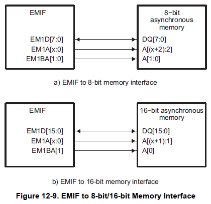

    The EMIF can support 8-bit, 16-bit and 32-bit bus accesses. The EMIF has a different design lineage from XINTF so the 32-bit access is implemented in a different way. Instead of using XWE1n to indicate a 32-bit access, the EMIF allows the user to configure a different access mode for each CSn signal (memory region), and only one CSn signal is used per memory region.
    I should point out that the EMIF address bus is 32-bit native and requires the mapping to shift when using 16-bit and 8-bit access:
    -Tommy

    Yes, EMIF does support byte-level masking of the data bus so if you configure the CS space for 32-bit mode, the EMIF can still generate 16-bit operations by masking the invalid bytes using the DQMx signals. The EMIF implementation should be more straightforward for memories because they typically use compatible byte-enable signals.
