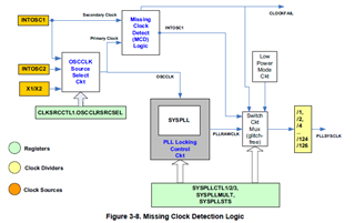

    Thanks for providing more details but first wanted to answer the MCD question.  MCD by default is enabled so anytime the primary clock in the system gets missing for some reason, the mechanism described in the TRM for clock detection takes over and there will be indications that this occurred through NMI or through some status bit in MCDSTS.  For the intent of your function, you can poll MCDR..SYSREF_LOST_MCD_EN to see if it ever got set.  For the internal oscillator, likelihood of clock missing is statistically very minimal as the internal clocks are always on.  MCD will be more relevant if external clock is used since this is a way for the system to detect if there is a break in the clock path (X1) to the device or for some reason the power to the external clock gets interrupted.
     Now, let's refer to the figure below for reference:
    If my understanding is correct, you are intending to have OSCCLK sourced by INTOSC2 so it will produce PLLRAWCLK, right?  If this is the case whatever is the variation in INTOSC2 will be the exact variation in PLLRAWCLK (proportional to IMULT and the dividers) so you really cannot measure the variation if you are connecting INTOSC2 and PLLRAWCLK to the DCC counters. My suggestion is as follows:
          - choose INTOSC2 as OSCCLK source to clock PLL to produce PLLRAWCLK
          - Connect XTAL as your base timer for the DCC (DCC source 0) and PLLRAWCLK as DCC source 1.
    XTAL (the on board crystal in the launchpad) is an independent, accurate, low variation clock source that can be used as reference to the DCC counter.  Hope this makes sense.

    To be clear, MCD logic is monitoring OSCCLK that feeds to PLL block.  Diagram below:
    MCD is outside of the DCC block.  How are you emulating a missing clock?
