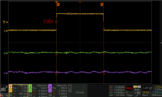

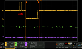

I use the new code modified from the code that has successfully implemented encoder reading data on F280049C-Launchpad, and the hardware resources are the control board designed by our company (the chip is F280049c).I tried to measure TXen(GPIO5) waveform, SOMI (GPIO10) waveform and Clks (GPIO3) waveform, but unfortunately only TXen waveform looks normal, SOMI looks abnormal, Clks waveform cannot be measured.Their waveforms are shown below:
Figure 1: Waveform of TXen
Figure 2: Waveform of SOMI

  • Hi<
    are you using the same resources when you were experimenting on the F280049C launchpad?
    Did you have to change any GPIO or XBAR configuration from Launchpad to you own hardware?
    Since the hardware is designed by you, I cannot say if the GPIO configuration is correct or not.
    Make sure the pins/GPIOs are configured according to your h/w.
    Also, check s/w configuration of CLB, SPI before debugging hardware further. Check the clock first and then command going to the encoder.

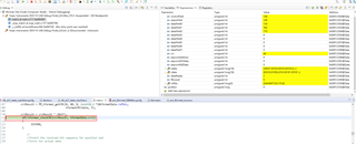

    Thank you very much for your guidance. My encoder looks like it can read the data, but the code stops at:
    if(!tformat_checkCRC(crcResult, tformatData.crc))
    ESTOP0;
    Can you give me some guidance on how to solve the problem? Thank you very much!
    Best Regards
    Johnson Alanl
  • First check that this is really where it stops.  If optimization is enabled in the compiler options then the source code debug view maybe misleading.  Check the disassembly window to get a better verification of the PC's location or temporarily turn off optimization in the compiler settings.
    If this is where the code stops, then the CRC received from the encoder does not match what the C28x calculated.  Since you tested this same algorithm on F2837xD, the algorithm should be fine and it is likely an issue with the data not being captured correctly - perhaps noise or power issues?
  • Another thing you can do is compare the data to your working system - both coming out of the SPI and using a 'scope.
