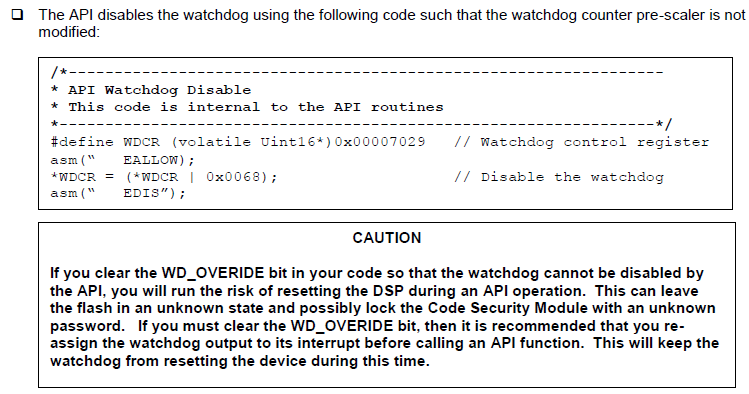

    Do you have watchdog or missing clock enabled? It would be good to check the flags in WDCR, PLLSTS, and NMIFLG to see if any of the fault detection circuits asserted a reset.
    Can you monitor the supplies to make sure that they are well regulated? The BOR can assert a reset if the voltage levels are out of spec.
       The next line of code of 3F39FB has changed from a normal code to an illegal interrupt code.
    This is a flash location so it is likely that there was an erroneous execution of Flash_Program() that took place. It's possible that the flash contents were corrupted by an electrical disturbance, but this is much less likely.
  • Can you monitor the supplies to make sure that they are well regulated? The BOR can assert a reset if the voltage levels are out of spec.

  • It's possible that the flash contents were corrupted by an electrical disturbance, but this is much less likely.

    Use an oscilloscope to monitor the VDD and VDDIO supplies to make sure that it is maintained within the datasheet recommended operating conditions.
         This phenomenon is probably because the chip is normal after being powered on for a period of time, and the next line of code that runs to 3F39FB again changes from normal code to INT5 that is not enabled. The customer checks that the power-on is normal, and then confirms that the reset is caused by the watchdog. The reset of the watchdog is because the program has entered a cyclic program without an enabled interrupt.
    I recommend focusing on the problem of code corruption in flash. The undesired branch to INT5 is caused by the flash corruption.
    Can you confirm that there are calls to the Flash API to program flash contents during operation? If so, is this CAUTION from the Flash API UG observed?

  • Shaoxing,
    Based on the information provided, I believe the following to be true:
    • Once the flash is corrupted, the CPU behavior is expected because it is executing corrupted instructions
    • The flash is not suffering from physical damage because it can be reprogrammed
    • Something at run-time is causing the flash to be corrupted, where the most likely causes are:
      • Faulty input parameters passed to the Flash API calls
      • Power disturbances while the Flash API is attempting to program the flash
    Can you confirm if the application is trying to program flash during operation? If so, please focus on the API calls and power stability while programming.
    -Tommy

  • Shaoxing,
    Ideally, the next goal would be to reproduce the failure in the lab for further debug.
    I would recommend an audit of the Flash API calls to make sure that they are not susceptible to corner cases where the wrong address or size might be passed in.
    If the failure is reproducible, they can add range-checking to the Flash API calls for the purpose of halting the execution in place if the wrong flash address is being programmed. This would be helpful for tracing the error.
    -Tommy
