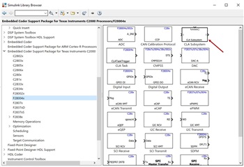

    I have one questions related to the CLA:
    1. How do I find the cla_subsystem block?
        it seems it is supported according to the following link: C28x CLA Task
          I already loaded the tic2000demospkg package.
          I went to C CODE > Code Interface > Embedded Code Dictionary > Manage Packages , I clicked on refresh to get the tic2000demospkg package to appear and then I clicked on Load.

  • Hi Romy,
    Are you referring to the following block? if yes, then this block is available only from the R2021b version of MATLAB.
    Venkatesh C
  • Hi
       I don't have that block. I need to upgrade the matlab version from 2021a to 2021b.
