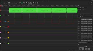

When my customer was testing HRPWM, he found that the period of PWM would have a jitter of 2*TBCLK.
That is, a frequency jitter of 8Hz appears at a frequency of 20KHz, which is shown in the red part of the waveform in the figure below.

You need to SET on CMPAU and CLEAR on CMPAD. You need to center the wave around CTR=PRD event.
