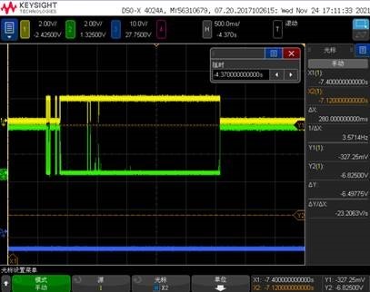

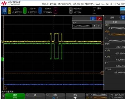

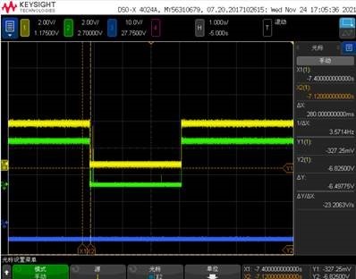

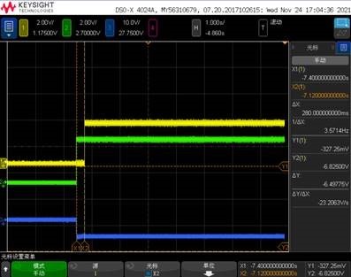

    3. Test result(Yellow—match2, green—protection signal input from DSP, protection signal low level means match2 needs to output high level to block PWM)
    (1) Normal waveform
                        artificially simulate abnormal conditions                                                       artificially simulate abnormal conditions  (zoom in)
    (2) Bug waveform
                                   The moment of startup                                                                                  artificially simulate abnormal conditions
    In summary, match2 has been in an abnormal state after power-on during the bug.
