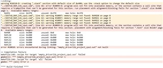

I am using the following empty project inside C2000Ware_3_04_00_00.
C:\C2000Ware_3_04_00_00\driverlib\f2837xd\examples\dual\empty_projects
After I wrote some code in the project, I started getting the following errors.
I added the "RAMGS0 | RAMGS1 | RAMGS2 | RAMGS3" sections to the project because of insufficient RAM.
The "2837xD_RAM_lnk_cpu1.cmd" file of my project is attached.
How can we solve this error?

Please take a note on the error message. It says the .text is of size 0x1de7 and the individual memory blocks are of size 0x800. To fit in a section of size 0x1de7, you need to combine 4 consecutive memories

This works if the linker is able to split the .text section to smaller subsections. By default, the sections can be split at file level. If you have gen_func_subsections turned on, compiler treats each function as separate subsection. But if a single function itself is bigger than the size of a single memory block, linker cannot split this further and allocate across memory blocks. hence you need to combine memory blocks to form larger blocks.
In your case if you move the RAMLS2_3_4_5 definition under Page 0, the issue should get resolved, I believe.
In fact, it is not required to split the memories as PAGE 0 and PAGE 1. you can keep all the memory blocks in PAGE0 itself. This was required for some of the older devices to divide program and data memory. It is not mandatory for this device
