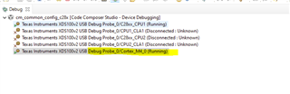

    However, in cm_common_config_c28x example, I added _FLASH in predefined symbols and selected respective flash linker file and also added while(1); in the end of main() and then debug the application.
    Next I stopped debugging and in enet_lwip project selected CM Core in debug configurations and tried debugging but I see that control is not coming out from function Ethernet_init(const unsigned char *mac);
    Instruction --> pInitCfg = Ethernet_initInterface(initInterfaceConfig);
    So far I have not made any changes in enet_lwip source code as suggested in above thread.
    Do I need to make respective changes if needed to make lwip run in Standalone and debug mode?
    Update 1:
    So I added LED Blinking in while(1) loop of cm_common_config_c28x example and flashed that to CLA1/CPU1 and then I tried flashing enet_lwip example to CM core I observed that CPU1 flash is also getting erased when I tried flashing Cm.
    Is this expected ? Any HW changes required for flashing CPU1 or CM ?
    Update 2:
    I'm able to bring up LwIP on CM successfully, The mistake I as doing is loading both Flash separately, Instead of that need to flash to CM from CPU1 debug configurations window, i.e., First running cm_common_config_c28x  on CPU1 in debug mode and then select CM Core from below window and Load program of enet_lwip on CM and then right click on CM Core and connect to target.
    In this way I'm able to ping successfully.
