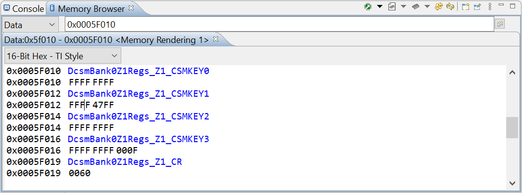

  • Vamsi,
    The F280049C is unsecure, please refer to below snapshots,
    If I set Z1OTP-CSMPSWD0 to 0x12345678, then CCS will fail to erase flash memory of F280049C. However, CCS can erase and program flash memory of F280025C without problems when I do same experiment.
    I would like to know the reason why the flash operations are different between these two devices.
    Thanks and regards,
    Luke

  • Luke,
    You need to follow correct procedure to be able to program the flash and correct procedure is to provide valid password in password fields in GUI. In this case you are providing in-correct password in GUI hence you see a failure. I also see here "--" value in CSMPSWD1 field which is also not correct. We do enhancement to our security scheme and also to tool on new devices and there may be some differences in behavior on different device. Please follow correct procedure by providing correct password value and is you still have issue, we'll look into it.
