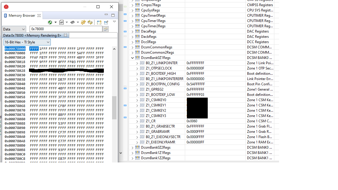

I'm trying to get DCSM finalized on a project. I can write the keys, Pwd Lock, BootPin Config and Bootdef. All those values seem valid and written correctly.
I can start up the processor with the debugger, but it will not startup on it's own.
Originally: I left BOOTPIN_CONFIG ALONE (ALL F's) (GPIO 32 and 24 are pulled high), It would not start.
I wrote: 0x5AFF FFFF to BOOTPIN_CONFIG to force it to BOOT Def0
BOOTDEF_LOW is set to 0xFFFF FF03
BOOTDEF_HIGH was left alone (0xFFFF FFFF)
In the image is the DCSM Z1 register:
Is there something else I am missing?
For reference I was able to figure out that the processor seems to be stuck in the boot rom:
On connect: 0x3FC7A5
If I run after connect: 0x3FBD46
Not sure if that helps...

When you program the password for a zone, you also need to program the GRABSECT field to allocate to flash sector to that zone or make it unsecure. If you leave the value to default ('b11) then flash sectors will be in-accessible if zone is locked. Please refer "Table 3-103. B0_Z1_GRABSECTR Register Field Descriptions" which describe the definition of GRABSECT fields.
When you are connected to debugger, it look like zone is getting unlocked (Z1_CR values is 0x60 which means UNSECURE is '1') hence it works fine.

So I've moved the memory to zone 1 and it still will not startup into flash. I made my code's first line to turn on an LED and that doesn't even work, so it's a not memcopy error or something along those lines.
The DCSM registers appear correct... Z1 requests all memory, Zone 2 says no request (I did try it without the no-request from Z2... it also didn't start)
The PSWDLOCK fields may have been corrupted with all of this. And that might be it, but I think it's probably something else...

OK... So I was able to track it to what looks like to to be the problem. Not sure how to solve it...
It appears my OTP looks to be set correctly. Boot mode is coming back as 3 and it moves to flash boot, but it halts before code is run.
The Boot mode seems to be halting on "Flash Uncorrectable Error" in this statement:
if(cbrom_nmi_status & NMI_FLG_FLUNCERR) /*check for C28FLUNCERR NMI */
cbrom_status |= BOOTROM_GOT_A_FLASH_UNCERR_NMI;

How are you programming the security settings in OTP? Can you check the value of "UNC_ERR_ADDR_LOW" and "UNC_ERR_ADDR_HIGH" register in CCS register view let us know.
Vivek Singh
It's the address 0x78010... Looks like CSM password was written incorrectly... I'm guessing this particular processor has been bricked.
I was writing the CSM password with the debugger (ECC autogeneration is enabled), but I may have tried to flip the bits twice (one bye once, and then the other byte later). This may have screwed up the ECC...
