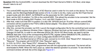

    TI provides SCI flash kernels - please read this: https://www.ti.com/lit/sprabv4
    Below snapshot is taken from this application note:

  • Pravin,
    The controlCard will work with the flash kernel example by connecting the mini-USB cable to the A:J1 port. You do not need to attach anything to the pins on the docking station. Please follow the steps outlined in the flash kernel app note screenshot above to run the example on the controlCard.
    Anu
  • Thanks Vamsi & Anu for your reply.
    1. I have followed the procedure as mentioned in the document. but in command terminal my screen is stuck on-
    Usually, how much time kernel downloading takes?
    2. Also when i connect CPU1 in CCS7 and changes content of 0xD00 to 0x815A manually in memory window, it reflects in memory view. But, the content gets reset to 0x035A when I disconnect. Same thing happens with CPU 2.
    3. I feel that 1 is happening due to 2, correct?

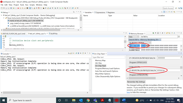

    1. No, I didn't modified linker command file. used as it is. Do I need to modify it? In addition to that I modified the value of Z1_BOOTCTRL (0x7801E) to 0x0000815A (to use SCI Boot mode). But after modification I am following below behavior:
    2. LED on CPU1 blinks (as expected) when CPU1_RAM and CPU1_FLASH is debugged trough TI XDS debug port. If I power reset the control card LED doesn't blink. Is it expected?
    3.Why program is not getting executed from FLASH memory?
    4. Also, I noted the value difference of values in CCS and memory map on location 0x7801E (encircled in image below), can you explain this please?
    5. I am able to do the SCI flashing with switch position 1,0 & 1,1 (through codeskin c2Prog utility); does it mean CPU1 is not coming out of GetMode boot?
    Please, help me with on priority basis. I am running out of time.
  • Pravin,
    First, regarding the Uniflash question, you cannot use it for SCI flashing.
    Regarding your other questions -
    If you intend on the device going to Flash after a reset, you need to program the OTP to go to Flash Boot - you currently have it set to SCI Boot. The SCI Boot Mode is used to download the flash kernel via the SCI Bootloader to RAM. The device is most likely going to the SCI bootloader, and that is why you are not seeing the example being executed from Flash. Since you cannot modify the OTP here, in order to get out of the SCI bootloader, you need to send it an incorrect key, any value other than 0x08AA - please refer to the screenshot below from the boot chapter of the F2837xD TRM:
    Once you are in Flash, if the images have been programmed correctly, you will see the LEDs blinking.
