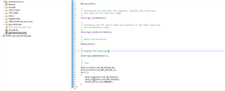

The code is just toggling GPIO output:
Building in RAM everything is OK.

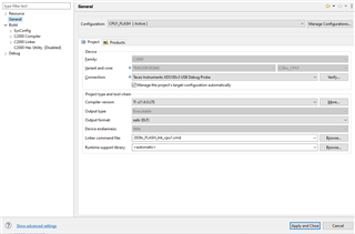

Building in FLASH for the first time, I receive an error: "line 33: fatal error #1965: cannot open source file "board.h"", then I re-try to build again, the error disappears **** Build Finished ****. After programming the code runs, if I reset the power the stop does not run.
I am using CCS V11.1.0.00011
Project properties are configured for F28388S CPU1 connection XDS100V3 (I am using the OLIMEX XDS100v3):
Any idea what is the issue? I am pretty sure it is related to the error the first time I build in FLASH.

  • Hi Vamsi, thank you for your help.
    I started the project using the example: gpio_ex2_toggle.c from C:\ti\C2000Ware_4_00_00_00\driverlib\f2838x\examples\c28x\gpio
    As it is intended for a 2838D with the XDS100V2 I changed the target config for XDS100V3 et Device F2838S. Then I also changed the Sysconfig for the F2838S: and choose my GPIO.
    That pretty much it, really simple and straightforward.

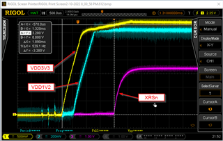

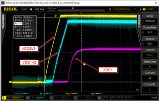

    I dug a little bit further and discovered it is actually booting on FLASH sometimes, but 80% of the time it does not.
    I tried with another new board and it behaves the same.
    What I observed:
    1. I flash my program in Flash, keep the JTAG connected on the board (XDS100V3 Olimex)
    2. My program is running
    3. Power cycle the power supply
    4. The uC does not boot in flashNegative squared cross mark
    5. Disconnect and reconnect the JTAG from the board
    6. Power cycle the power supply
    7. The uC boot in flash White check mark
    8. Power cycle the power supply
    9. The uC does not boot in flashNegative squared cross mark
    10. Disconnect and reconnect the JTAG from the board
    11. Power cycle the power supply
    12. The uC boot in flashWhite check mark
    13. ...
    So there might be something with the boot sequence and timing issue or with the JTAG pins.

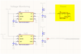

     My schematic is pretty much the same as the ControlCard, I am using the TPS62410DRCR for the 3V3 and 1V2 instead of the TPS62420DRCR (was out of stock everywhere)
    And I am using two supervisors to monitor the voltages, same as the control card:
    And the two GPIO are tied to 3V3 to boot in flash:
    I will try to probe the MCU_XRSn and make sure everything is as expected:
    Other than that, let me know if you have any suggestions.
    Alexis

  • I probed the signals 3V3, 1V2, XRS and 25MhzClock and GPIO72 and 82:
    From what I see the XRSn goes high too soon when the uC does not boot in flash.
    When it works the XRSN takes around 2ms to go high.
    I mounted on my board a reset switch:
    And when I press the switch the uC is now booting to flashSmiley Thinking, same if I keep the switch pressed, power the board and release the switch it goes to flash.
    The supervisors 3V3 and 1V2 look like they are doing there job...
    Is there anything inside the uC that should keep the XRSn signal low during the power  up?
    Is it possible to assert a reset later after the POR or add a delay after the tw(RSL1) = 100us(Typ)?

  • From what I see the XRSn goes high too soon when the uC does not boot in flash.
    From what I see the problem is not with the XRSn going too soon or too late, the supervisors are doing its job perfectly, and because the 3V3 rail is below 3.17V (datasheet threshold) XRSn must be held low.

    I can share the schematics if you are interested to take a look at it.
    PCB_F2838_Node_TI.pdf

    When I toggle the power supply and it does not boot in flash:
    When I wait 5sec and it does boot in flash:
    As Andy was saying, the two supervisors do their job, the 3V3 slope is different and make the XRSn low longer when it boot vs when it does not, I am not sure if it is a cause or the reason why it boots to flash Sweat.
  • I would pay more attention to the power supply. The 3V3 really shouldn't behave like this. Can you also check the +5V supply? Maybe there is something wrong?
    Andy
  • Ah, I now see the slope change in your earlier post, it is much more clear in these photos.
    I absolutely agree with Andy, we need to know why the 3.3V rail is behaving this way, the 5V rail may give some clues.
