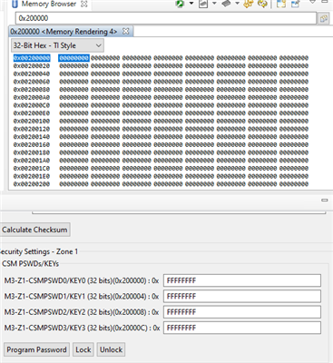

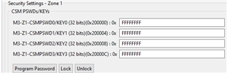

    Yes I have indeed looked at both those posts.
    If I look at the In-flash Gui the Passwords show FFFFFFFF. In the memory browser at address 0x200000 and 0x2FFFDC it's all zeros.
    Does this mean the passwords were changed?
    In the .map file it does not seem that anything was written to the password locations. (I am trying to upload the file to this post but it does not work)

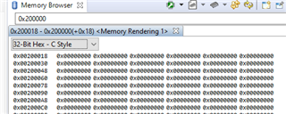

    The Memory browser images you have attached are not showing the correct starting address. Can you please choose 32-Bit hex - TI Style?

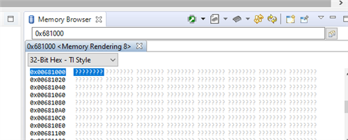

    I looked at your .map file. What is .init_array that is assigned to 0x681000 (OTP - Security lock)?
    Are you using a linker command file supplied as part of controlSUITE? Or did you modify the supplied linker command file for your application? If it is the former, please provide the name of the file and the controlSUITE version. If it is the latter, please rename the extension to .txt and provide it.
    What version of CCS are you using?
  • Hi Hareesh.
    Thanks for that clue. I further investigated the .init_array and narrowed it down to the standard vector library. It was when I declared a vector in my new C++ code, when this init_array was added by the compiler and automatically placed in that memory space. After some searching I came across this post with a similar problem:
    https://e2e.ti.com/support/tools/code-composer-studio-group/ccs/f/code-composer-studio-forum/231783/concerto-f28m35x-can-i-use-standard-vector-template
    I then added a section in the linker file to place the init_array in a valid memory space like this:
    .init_array :   >> C0 | C1 | C2 | C3 | C4
    This seems to have sorted out the cause of the problem and I can now load my program onto the target. However the program does not run correctly and If I view the variables it seems that the symbols are all mixed up. It also doesn't stop at a break point where I expect it to stop. What is the correct way to edit the linker file, or anything else I should do, to ensure that this init_array is placed in the correct location? Here is my current linker file:

    Also, I still sit with 3 boards that is now locked and not usable. It also seems that I cannot unlock them because the password locations have been written with zero's:
    If I try to access the OTPSECLOCK at address 0x681000 the device disconnects:
    Does this mean the device is permanently locked or is there a way that I can recover it?

  • Does this mean the device is permanently locked or is there a way that I can recover it?
    I wonder if the passwords are shown as all zeroes because (i) the device is locked or (ii) the passwords are indeed all zeroes. If the password locations have indeed been programmed with all zeroes, I am afraid there is no way to recover those devices. However, I wonder why the flash locations would have been programmed in the first place, since I don't see flash memory in your .map file. Did you try unlocking your device with a "password" of all F's?

  • If I try to unlock using the on-chip Flash Gui with all F's I just get the message "Target not connected or does not support current flash operation". There was one occasion where it actually said the target is unlocked successfully, but I still could not erase the flash or load a program. Unfortunately I don't have those console output any more and I can't seem to duplicate that result.
    There does however seem to be an issue with this memory address 0x681000 because it keeps crashing when I try to access it.
  • Ok, noted thanks. I will keep on using this workaround for now. But for some reason my program still behaves strangely as soon as I declare a vector. Even after I added the line in the linker file section to place the .Init_array in a proper location.  Is there some other way to deal with this Init_array form the standard vector library?
    Edit: Update! I found the reason why it was still not behaving correctly. I was calling some function in my class constructor before the relevant registers were initialized.
    So my project is working now. Only problem left is those boards that I cannot access.
  • There does however seem to be an issue with this memory address 0x681000 because it keeps crashing when I try to access it.
    Address 0x681000 is OTPSECLOCK location, part of the code-security-module. Access to secure resources when the device is secured would break the debugger connection, which is probably what you are seeing.
    Regarding the boards you cannot access, it appears the devices got locked inadvertently with unknown passwords. Unfortunately, there is no way to recover from this. One thought: Up until the M3ZxPSWDLOCK bit is set, the device is not secured. The password locations may contain the passwords, but the device is not secured until that bit is set. We now understand your project unintentionally wrote to OTPSECLOCK, thus locking the device. However, the password locations themselves should contain all F's, so I don't quite understand why you are unable to unlock the device with a password of all F's, unless the password locations also got written with some unknown values. Anyway, I will go ahead and close this post, since your original issue appears to be resolved.

  • HI Hareesh
    Yes, the root cause is now resolved. Thanks for giving some pointers to narrow down that issue.
    However, the side effect of the boards being locked was actually the original reason for this post. And I would please like to continue looking at the boards, even if we have to create a new thread, because I am not convinced yet that they are permanently locked. Here is me reason why. I was able to reproduce what I had seen earlier. I can connect to the device and this is what the password memory looks like.
    Then I Click on Unlock and this is the output:
    Cortex_M3_0: Performing Security Operation...
    Cortex_M3_0: The device is currently unlocked, and therefore it is not necessary to perform the unlock operation.
    Cortex_M3_0: Operation completed successfully.
    Which means the device is not locked right? But if I then try to erase the flash, this is what I get:
    Cortex_M3_0: Erasing Flash memory...
    Cortex_M3_0: GEL: Error while executing OnReset(0): Target failed to read 0x00681000
    at R1=*(0x681000) [f28m36h33b2_m3.gel:327]
    at Read_OTPSECLOCK() [f28m36h33b2_m3.gel:55]

    So what is going on with this device? Is it locked or not?
  • Albert,
         We are making some assumptions about the state of the device, which may or may not be true. In theory, we have reasons to believe you should be able to unsecure the device, but evidently, you are unable to do so. It is hard to debug such issues without access to the hardware. I am thinking through this some more and brainstorming with colleagues. I will get back to you sometime middle of next week with possibly more leads.
  • Albert,
        Just wanted to check on where you are with this. Did you face this problem with any new devices? I am unable to think of reasons why a device's password locations were ostensibly untouched by the project and yet you are unable to unlock the device (unless a brownout during programming left the password locations in an unknown state).
  • Not any progress. No, not with new devices. Only the ones that I have programmed with my faulty code where .init_array was accidentally placed in 0x00681000.
    It seems that the device is not just simply locked and I have to unlock it. It is as if the device got corrupted and now It behaves strangely. Whether I try to load a program, erase flash or unlock, it has some error related to memory address 0x00681000.
    Erasing Flash Output
    Cortex_M3_0: GEL Output: Watchdog Timers Enabled
    Cortex_M3_0: GEL Output: UARTs Enabled
    at OnReset(0)
    Unlock output:
    Cortex_M3_0: Error occurred during flash operation: Target failed to read 0x00681000
    Cortex_M3_0: Error occurred during flash operation: Target failed to read 0x00200018
    Cortex_M3_0: Error occurred during flash operation: Target failed to read 0x0020001C
    Cortex_M3_0: Error occurred during flash operation: Target failed to read 0x00200000
    Cortex_M3_0: Error occurred during flash operation: Target failed to read 0x00200004
    Cortex_M3_0: Error occurred during flash operation: Target failed to read 0x00200008
    Cortex_M3_0: Error occurred during flash operation: Target failed to read 0x0020000C
    Cortex_M3_0: Error occurred during flash operation: Target failed to read 0x400FB480
    Cortex_M3_0: Device unlock failed. Device is still locked. Please check the provided password.
    Cortex_M3_0: Error occurred during flash operation: Target failed to read 0x20004000
    Load program output:
    at OnReset(0)
    Cortex_M3_0: File Loader: Verification failed: Values at address 0x20000000 do not match Please verify target memory and memory map.
    Cortex_M3_0: GEL: File: C:\Users\alberts\Documents\Albert Work\Software Projects (Git repo's)\Concerto_RogueTest_M3\RAM\Concerto_RogueTest_M3.out: a data verification error occurred, file load failed.
    Cortex_M3_0: JTAG Communication Error: (Error -1170 @ 0x0) Unable to access the DAP. Reset the device, and retry the operation. If error persists, confirm configuration, power-cycle the board, and/or try more reliable JTAG settings (e.g. lower TCLK). (Emulation package 9.3.0.00042)
  • OK, thanks for the update. I am afraid there isn't much we can do to debug this further.
