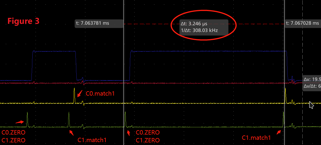

    Measured waveforms: in most cases, it's normal. Occasionally, exceptions occur.
    Figure 1-2 is the normal waveform, and figure 3 is the exception:

  • Hi Cherry,
    Thank you for the additional information. So if I am understanding correctly, the HLC program involving counter 0 works as desired most of the time, but there are instances where it malfunctions (as in the circled part of the waveform in figure 0). Is that correct?
    If so, I have some additional questions for the customer:
    • Is this issue happening after a consistent number of cycles after running the program, or is the issue happening at random?
    • Is the waveform affected for cycles after the "glitch"? From the first set of images, it looks like the counter runs consistently and the counter1 match values do not go high for one cycle. However, in figure0 from your recent post, it looks like the subsequent cycles are elongated after the first "glitch".
    • Is pipeline mode enabled?
    They've done some tests, and it should not be caused by glitches. The glitch in the above figures was caused by a C0 reading exception.
