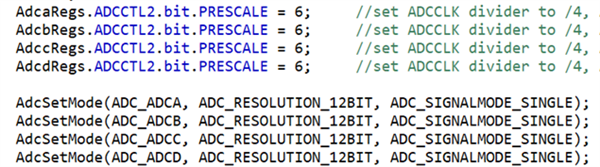

The ADC configuration of the 28377D used by the customer is as follows:
the ADC reference voltage is 3.2V, the ADC clock is 50MHz, use the 12-bit single-ended mode, the sample hold time is 120ns, the conversion of ADC A is triggered by 30kHz EPWM, and SOC0~3 are configured channels 2~5 respectively.

  • Hi Matthew,
    After sampling channel 5, the customer samples channel 9 again. The result is that the sampling value of channel 2 is not affected by channel 5. The settings are as follows:
    In addition, after SOC0~4 is sampled, the next round of SOC0~4 sampling will be triggered after about 30us.
