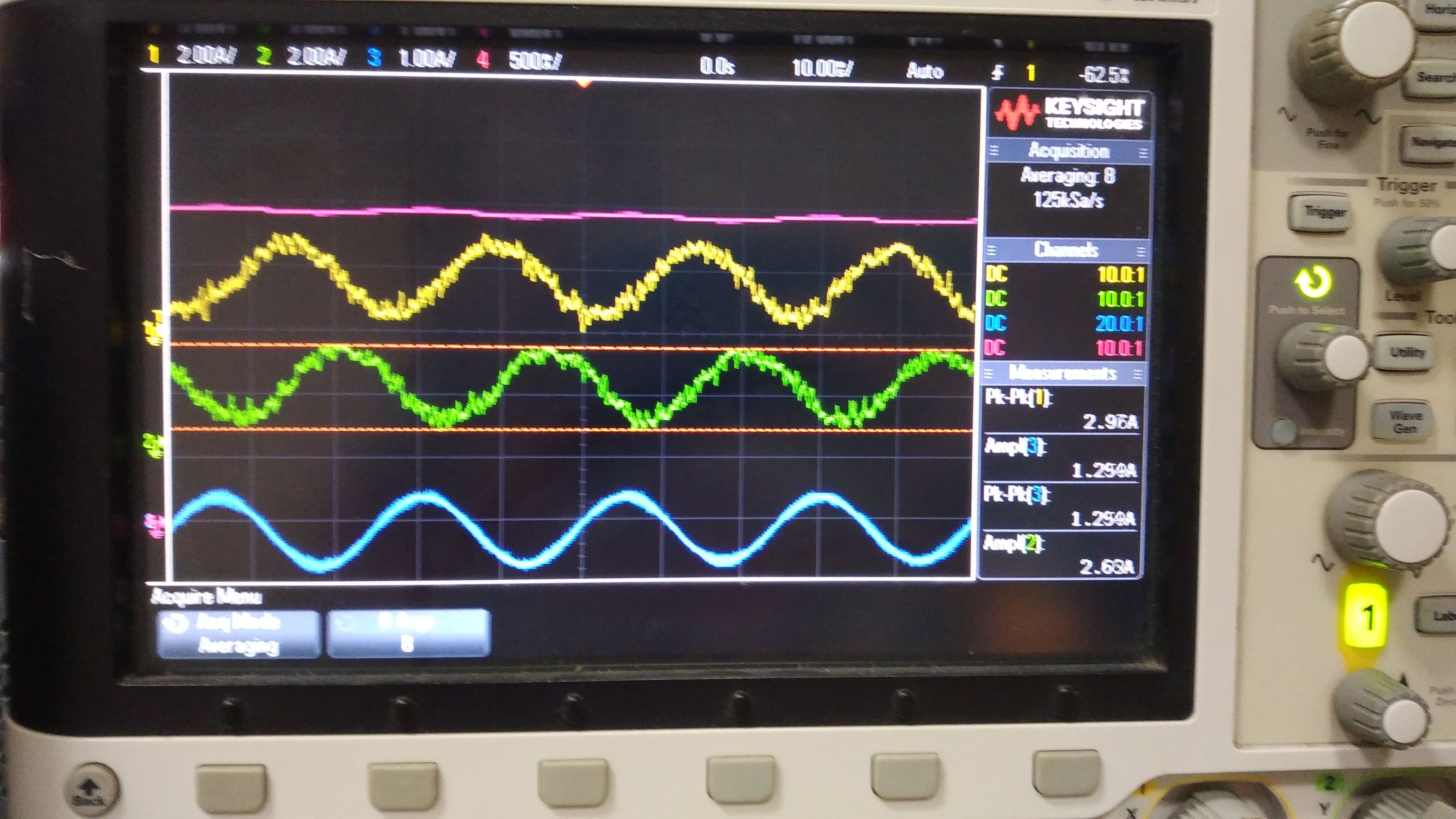

  • What I am trying to do : Run 3-phase Induction motor using Direct Torque Control method.
  • What I am sensing: 3-phase stator currents through current sensor board and speed through speed encoder.
    • MCU: TI C2000 F29069M
    • Level Shifter : 2.5 shift, 0.5 gain
    • Current sensor : 0.1 gain
    • The issue: Significant jumps in current retrieved and seen through DAC, even if the voltage supply is not given.
    Waveforms shown below:
    1. Yellow : Phase A current retrieved and seen through DAC
    2. Green : Phase B current in DAC
    3. Blue : Phase C current in DAC
    4. Pink : Phase A actual current sensed by current probe
  • Fig 1. Only shift seen in DAC as the code is not yet turned on.
  •                                                                                                       Fig 1. Only the shift of level shifter seen in DAc as code not yet started.

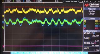

    Fig 2 Below shown when the inverter switching is started, these jumps are seen in the phase currents 1. 2. & 3 waveforms .
                                                                                                                                                           Fig .2 Jumps in current even though supply is off
  • Fig 3. When supply is given, the first three waves (phase A, B, C currents) are not sine wave as they should come as the 4th waveform (pink). 4th waveform is the phase A current through current probe.
  • Another issue I am facing is that the speed encoder is not giving some constant value of speed while running the motor. It is varying a lot by +-30 to 40 rpm which is affecting the speed control PI loop as well. Is it because of the encoder fault or in my code some problem is there?
  • I am attaching the .c code and also the video of current waveform and how the encoder result is varying. Please do take a look.
  • DTC_code_in_the_making_running.rar

  • Actually, sir, when noticed closely it seems that for phase A current, it is able to pick up the falling curves of the sine wave. Only the rising curves are either going flat or very high. Please see the image where the current sensor output and DAC output are being compared.
    Fig 1. Current sensor (blue) and DAC output (yellow) for Ia phase current
    Fig 2. Current sensor (blue) and DAC output (green) for Ib phase current.
  • I'm saying the FAST inputs of EMF position Va,Vb,Vc voltages shown below from the ADC may be reversed. It would seem the eQEP positional data has to feed FAST to rotate SVM sector changes by lower Clarke inputs. I tried to find the post too but seems to be missing. Reading above eQEP is only for speed (not position) so you still must have 3 voltage dividers unless the speed sensor can produce the Clarke voltage inputs or bypass with eQEP position codes module.

  • >>The current sensor is LEM sensor LA55-P.
    What range is the output voltage of the LEM sensor? Is there any signal deal circuit on the sensor board to convert the output to 0~3.3V for F28069?
    I am using ePWM 7A, 7B, 8A & 8B as DAC which is available on the F28069M board itself, so the frequency would be that as the ePWM timer that I am providing, right?
    What PWM frequency for the PWMDAC? And what RC filter is on the pin for PWMDAC?
  • Sir, I am not very familiar with the new FAST estimator and I am sure it would be better than this method but would also be time-consuming to learn as we are learning the coding on our own. One thing I observed is that the current when monitored through the current probe is, in fact, sinusoidal. Also, the speed is tracking the reference as well as the flux is tracking the reference flux. So the closed-loop is working fine. But I am not sure whether now this is the problem with the DAC.
  • Sir actually the current sensor is not the issue, because when I monitor the output of the current sensor it is sinusoidal as it should be. Also, the current sensor offers a gain of 0.1, and then the level shifter too offers a gain of 0.5. So the output of the current sensor + level shifter is well within the 0-3.3 V limit.
    The PWM frequency is 10 kHz and the RC filter  is : R = 361 k and  C = 0.1 u F
  • Hi Siddhi,
    Actually, capture seem more trapezoidal shape than a pure sinewave at points in the blue probe capture. Below is how my Hantek current clamp captures on the phase drives 80Hz - 90Hz rotor speed. FAST estimator SDK has SVM call produce SF=0.5v low harmonic distortion, GDSVM algorithm amazes me 50% duty cycle produces 0A current level. Seemingly sectors 7 & 8 in some examples are not actually switching NFETS, though also read in some articles mention your code shows binding high to low rail.
  • The PWM frequency is 10 kHz and the RC filter  is : R = 361 k and  C = 0.1 u F
    The PWM frequency is too low for a PWMDAC to view the current waveform. You may try to use 50~100kHz frequency for PWMDAC, and use the RC filter with R=470~5K, and C=0.1~0.47uF, like 2.2K/220nF, or 470/0.47uF.
  • Okay, sir. Actually, the RC filter is present on the board itself as shown in the pin map document (image attached).
    So in order to change the frequency of PWM DAC I have to change this register value: EPwm8Regs.TBPRD = EPWM7_TIMER_TBPRD;
    for 100 kHz frequency, right? i.e. 450
