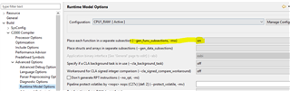

  • Hi Abaldur,
    Could you try disabling (off) below option if enabled?
    If this does not help, I will loop in our compiler team to help you.

  • Hi Vamsi
    Just tried your suggestion, but it does not seem to work. I still see the "#10068-D no matching section" warning and the libs still remain not linked. Right now I'm just testing with the "Flash2812_API_V210.lib", and I can confirm that only if I call functions from this library in my code, it will be included by the linker.
    Since I posted the question, I found that the linker has a command line argument --retain (Properties -> C2000 Linker -> Advanced Options -> Symbol Management) that sounds a bit like what I want. If you hover this option it says: "This option can be used to tell the linker to retain a list of sections that would otherwise be not retained". However, as it also says, it only works with the eabi (ELF) output type, but my project requires the TI-COFF type since I rely on libraries that are compiled this way.
