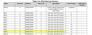

TMS320F280049C: CPU vectors outside ePIE peripheral core priority orders and ignores group clearACK noticed inside while for loops of core vectors
Guru 55913 points
Part Number: TMS320F280049C
I notice an issue with C2000 not behaving like ARM type CPU inside interrupt handlers. Seemingly race to instruction prefetch execution prior to termination by ( } ) syntax. The C++ compiler eabi.lib versions do not have this issue with ARM CPU only noticed in C2000. Perhaps the legacy COFF output format with TI v18.12.2.LTS has something to do with this odd CPU behavior?
Mostly noticed (for) and (while) loops process outside the functions last return and during increment count execution sequence. That is not proper behavior for next function to execute prior in either loop in clause variable count shown below. The loops shown below must complete prior to executing the outside and next function.

    3.5.4.2 Handling Interrupts
    ISRs are similar to normal functions, but must do the following:
    1. Save and restore the state of certain CPU registers (if used).
    2. Clear the PIEACK bit for the interrupt group.
    3. Return using the IRET instruction.
    Requirements 1 and 3 are handled automatically by the TMS320C28x C compiler, if the function is defined using the __interrupt keyword. For information on this keyword, see the Keywords section of the TMS320C28x Optimizing C/C++ Compiler v6.2.4 User's Guide. For information on writing assembly code to handle interrupts, see the Standard Operation for Maskable Interrupts section of the TMS320C28x CPU and Instruction Set Reference Guide.

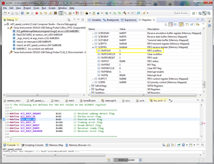

  • Can you clarify a bit if you think this is a issue effecting program execution or one that effects the state of watched variables during debug when BPs are inserted in the code?
    Condition occurs without inserted break points or CCS real time debug being enabled.
    Oddly my UART peripheral application with modifications for SCIB use the same (for/while) loops that work correctly via TM4C1294 though have major issues with C++ functions via x49c. Mostly relative to SCIB RX/TX FIFOs versus UART FIFO's of the TM4C1294 ARM cortex that have no such issues with stopping forward processing of C++ syntax after the function ( } ). The examples of the for while SysCtl_delay() were posted above to insert into added PIE interrupts of group1/9 with Instaspin SDK (FOC) being loaded.
    Only do we see debug single stepping (F5) cursor jump to the next function after the last functions return ( } ) mnemonic. The actual firmware (*.out) during debug (RUN) mode should never behave this way especially when break points were not set. So it could be the XDC110 debug emulation doing this jump as I think you seem to be suspecting?

    Supposedly it was occurring inside any ePIE interrupt handler. The TRM text states SCI RX FIFO is 10 bitwise read (23.13.1) but Fig 23-2 (Pg 2188) shows FIFO as being 8 bit wide?
    Oddly RX FIFO read bits via a (for) loop with (for) call timeout outer loop has very strange behavior. If you setup SCIA without interrupt or FIFO to do SCIprintf() as to indicate SCIB array[i] playback in the loop there is no ASCII data printed only header text appears 32 times putty USB3 virtual COM.
    Also the ePIE INT3 RX FIFO (SCIB) locks up after asserting RX serial command for CPU to send 32 bytes TX data via CPUTimer0. Alternatively calling executing below code (for loop) FIFO read function from inside TX interrupt handler. So it does the round robin transaction but locks the RX FIFO after issuing INTERRUPT_ACK_GROUP9 while ADCA1 interrupt errata set to continuous or not.

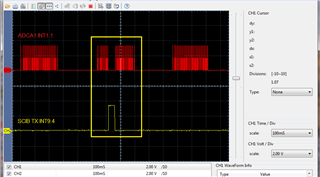

    Many (while) calls made from SCIB TXD call handler function that interrupt ADCA1. Include various sample sources SOC_NUMBER_0, 1, 2 via INT source ADC_INT_NUMBER1 Group 1. The same (for, while) loop method on TM4C1294 MCU does not cause odd problems.
    while(!(NexSendCmd("vis p10,1", 0, 0, 0)));//stop red led
    while(!(NexSendCmd("vis n12,0", 0, 0, 0)));//start green led

    You can add this SCIB code above to the Motor control SDK (FOC) on x49c launchpad, or I can do a project export share.  All you need is another launch pad to use for XDC110 SCIB circular prints via TXD called time loop. Can you get supervisor to ok purchase Nextion 3.5" LCD (500mA Max) sold on eBAY for $39.00, then load a binary of similar LCD pages via XDC110 Tx/Rx J101 header pins removed?
    Then we are talking the same scenario that locks SCIB RX FIFO immediately after TX round robin event. Recall above I stated this same nested for loop RX/TX round robin works without issue TM4C1294 MCU.
    Otherwise please load the SCIB ISR functions above into CCS so it becomes easier to read, syntax in color. Let me know if you see any odd syntax SCIB RX FIFO 10 bit reads into UNSIGNED CHAR (conversion) and load of MyArray[i] via nested for loop. Why might that lock RX FIFO after group 9 clear ACK.  Why no comment of RX FIFO 10 bit not shown Fig.23.2 SPRUI33D – NOVEMBER 2015 – REVISED SEPTEMBER 2020? Is that a misprint?
    23.13 6. Buffers. Transmit and receive buffers are supplemented with two 16-level FIFOs. The transmit FIFO registers are 8 bits wide and receive FIFO registers are 10 bits wide.
  • Would it be possible to use either of these examples
    Most the FIFO examples use blocking, the RX FIFO is interrupt driven. Basically code only checks for free TX buffer space being longer data strings output to LCD. The total size of longest RX command is only 8 serial bytes but some like (cfaults) are 7 bytes (sent twice), second set immediately after the first. That has more to do with C+ array transfers of data sent to the command interpreter for analysis.

    Finally noticed SCIB RX FIFO is generating OV error on the 2nd Rx/Tx round robin every time. Error is only visible under CCS debug register view and not vectoring RX handler to read SCIB RX Error status register. That is why it seemed like the SCIB RX for loop locks up each 2nd time during TX/RX round robins.
    The code I wrote above checks the RX status register only if ePIE generates an IRQ in group 9 and actually vectors CPU into SCIB Rx IRQ handler. It appears group1 ADCA1 (13KHz IRQ rate) is keeping lower order core pends from vectoring only on a 2nd round robin. Only rarely do I get SCIAprintf() error 90. According to subject matter the ePIE interrupt vector control is not properly configured in TI examples. Below text Table 23.13; CCS debug Real Time Silicon emulation is not vectoring into SCIB INT9.3 to services the RX error event, a lower group priority than ADCA1 group 1. Perhaps why (for, while, SysCtldelay) loops behave oddly.
    Part of the peripheral IRQ MASK and core priory order require a file, (DSP28_SWPrioritizedIsrLevels.h) left out of C2000 DSP folder, never being compiled with newer C2000 examples. Seemingly the ePIE silicon is passing un-restrained priority MASKED IRQ's up to the CPU. Oddly I am the only person on planet earth to report such insane ePIE peripheral behavior.
    SCI overrun-error flag.
    The SCI sets this bit when a character is transferred into registers SCIRXEMU and SCIRXBUF before the previous character is fully read by the CPU or DMAC. The previous character is overwritten and lost. The OE flag bit is reset by an active SW RESET or by a system reset.
    Reset type: SYSRSn
    0h (R/W) = No overrun error detected
    1h (R/W) = Overrun error detected

    Actually in CCS debug register view ADCA1 ACK is randomly toggling but SCIB ACK bit is staying 0x0100 it never toggles clear. That seems to explain how SCIB being 30ms ISR overruns faster ADCA1 125µs. Even configuring ADCA1 for 375µs ISR made no difference other than SCIB over runs slow down.
    There is a refresh rate associated with the display - so often a brief change may not be observed.  If I want to see how often an ISR is serviced then I will use a GPIO pin toggle in that ISR (ex: high at the start, low at the end) and view it on a oscilloscope.   If ACK is never cleared there will only be one interrupt.  If it is cleared then you will see the toggle for each.  This will also allow you to observe the execution timing as it relates to the ADC interrupt.

  • Hi Lori,
    Working Saturday is not just for mowing the lawn anymore Joy.
    I captured a more useful decimation of both groups. Notice SCIB is invading ADCA1 as it seems to be more than a single 125-250µs cycle. Each commutation period of Instaspin is defined user.h for 5 CMPD period counts of 50µs or 250µs/2 = 125µs each red pulse. Somehow Instaspin is out of sync with ADC interrupts like the priority of ADCA1 is being ignored at times.
    The PIE interrupt vector table can be viewed in the memory window to confirm it is setup correctly.
    ADCA1 INT1 is memory mapped as TRM 3.5.6 Table 3.4 as Segment: 0x0000.0D02: offset: DE0B.99CA 03C5.904F.
    SCIB INT9 is not being mapped, Segment 0x0000.0D12: offset: 0008.33A8  0008.33A8. Oddly EMUINT 17 0x0000.0D22 2 CPU Emulation Interrupt is mapped likely for debug interrupt.

  • I captured a more useful decimation of both groups. Notice SCIB is invading ADCA1 as it seems to be more than a single 125-250µs cycle. Each commutation period of Instaspin is defined user.h for 5 CMPD period counts of 50µs or 250µs/2 = 125µs each red pulse. Somehow Instaspin is out of sync with ADC interrupts like the priority of ADCA1 is being ignored at times.
    Lets go back to SW nesting vs not nesting - to make sure we are on the same page:
    Without interrupt nesting:
    • SCIB ISR is asserted
    • hardware disables interrupts
    • ADC1 will be ignored, even though it has a higher priority, until SCIB ISR completes.
    • When the SCIB ISR completes, are re-enabled by the context restore, highest flag interrupt will be taken
    With interrupt nesting
    • user re-enables interrupts using the nesting scheme
    • ADC1 ISR can be taken and interrupts the SCIB ISR
    • ADC1 ISR completes
    • SCIB completes, interrupts are re-enabled by the context restore, highest flag interrupt will be taken
  • The highlighted vector is not used.  It is likely populated with the default ISR for debug purposes. Refer to this table in the Technical Reference Manual.
    SCIB RX and TX vectors are found in group 9, memory address 0xDC4, oxDC6
    The address of the interrupt service routine(s) can be found in the linker generated .map file.  This can be checked against what is loaded into the PIE vector table.  Alternatively you can place a breakpoint in the ISR, run and once you are there, check the address.
    Lori
  • The address of the interrupt service routine(s) can be found in the linker generated .map file.
    So the one printed above was not used and further down memory was group 9. I used the other dot method to register all the interrupts. Yet ADCA1 was still being interrupted by SCIB TX INT in the middle of commutation when there is so much free time on either side of Instaspin ISR pulses. Curious that I thought Group9 address (0x0000.0d12) was needed for the peripheral core vector 13 being un-nested. Seemingly Group 9 INT9.4 (30ms) priority 13 should be chopped up not ADCA1 INT1.1 priority (5).
