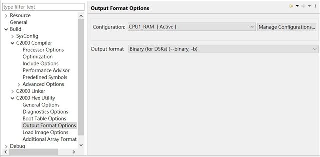

I am asking for my customer. They would want to have .bin output format.
Would you please show me the set up for having the .bin output format
I am doing the step with Enable ' C2000 HEX Utility - > set the Specify memory width to 16 and Specify rom width to 16 in General Options -> Select Binary (for DSKs) (--binary, -b) in Output Format Options .
While the customer follows the steps, and look up the final output .bin file. They discover the content of .bin format which it doesn't match the content from the Intel hex format, and also showing the errors after Rebuild project. The error wouldn't show by build icon.
gmake: *** [all] Error 2
gmake[1]:***[project_name.bin]- Error - 1073741819
May I make sure is there any missing setting for the .bin output format ?
