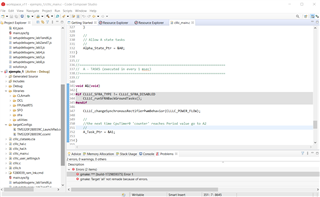

  • I already did a new projject and is showing this errors
  • I already add the target but has this errors
    the problem is that how can I to know where is the error because the software not sending to the lineof that error

  • Hi Arturo,
    The error is saying that you don't have a 3.00.00.00 version of powerSUITE in your CCS project. Can you go into your CCS project properties and see what version you are using? If one isn't selected, you can manually add the powerSUITE product to your CCS project.
    Peter
