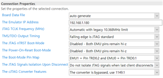

When I try to debugging my target board with your sample project like as 'led_ex1_blinky', I have trouble with using break point in flash mode.
I can use H/W break-point in the first MCU but can't use any break point in the second MCU.
The error message is same as below.
"Trouble Setting Breakpoint with the Action "Remain Halted" at 0x82ec8: (Error -1066 @ 0x82EC8) Unable to set/clear requested breakpoint. Verify that the breakpoint address is in valid memory. (Emulation package 9.5.0.00143) "
When I debug your project running from RAM, I can use break point in two MCUs both.
Is there any limitation of break point in JTAG chain for two MCUs ?

    1. Emulator: XDS560V2 STM LAN Emulator
    2. Test case (Set a breakpoint in MCU2)

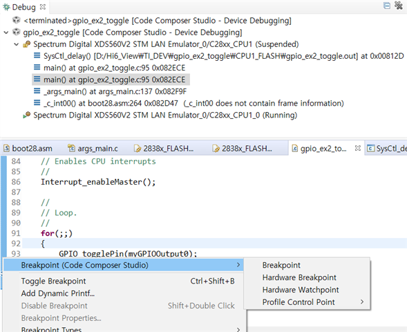

    Even though no brreakpoint set in MCU1(CPU1), I cann't set breakpoint to MCU2(CPU1).
    If I try to set a breakpoint on the left side of line number in MCU2, CCS tries to set a S/W breakpoint and fails.

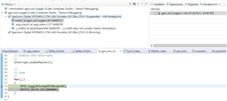

    3. Test case (Set a breakpoint in MCU1: Working well)
    H/W breakpoint is working well
    4.Can't I use any S/W breakpoint in flash mode?
  • PS)
    There is H/W breakpoint in popup menu in MCU1.
    There is no H/W breakpoint in popup memu in MCU2

    I believe your issue is related to the below known issue:
    https://sir.ext.ti.com/jira/browse/EXT_EP-10378
    There is a crude workaround. Try disabling ctools in CCS. To do this:
    -browse to <CCS INSTALL DIR>/ccs/ccs_base/emulation/analysis/bin/
    -rename ctools.dll to something else
    The start up CCS and see if you can set HW breakpoints on the second device. Note that you may get some error messages about unable to read a register but it is a false message in that there is no issue.
    Let me know if the workaround allows you to se a HW breakpoint on the second device.
    ki
  • Thank you very much.
    I can use the H/W breakpoint on the second device now.
