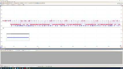

I am working on I2C Master Receiver and Slave Transmitter.
In Slave Transmitter Interrupt, Transmit Interrupt (I2C_TX_ISRC) enters before Address as Slave Interrupt (I2C_AAS_ISRC).
This causes index confusion.
I have attached the relevant files.
I would appreciate if you share an I2C Slave example for TMS320F28035.
Kadir B.

    I2caRegs.I2CMDR.bit.TRX = 1; /* Transmitter mode */
     * I2C Interrupt Enable Register (I2CIER)
     * 3h RRDY
     * 4h XRDY
     * 6h AAS
    I2caRegs.I2CIER.all = 0x0058;
    /* Enable I2C. */
    I2caRegs.I2CMDR.bit.IRS = 1;
__interrupt void i2c_int1a_isr(void)     // I2C-A
   Uint16 IntSource;
   // Read interrupt source
   IntSource = I2caRegs.I2CISRC.all;
   switch (IntSource) {
   case I2C_RX_ISRC:
       I2C_RXBuffer[I2C_RXIndex++] = I2caRegs.I2CDRR;
       I2caRegs.I2CSTR.bit.RRDY = 1;
       break;
   case I2C_TX_ISRC:
       I2C_TXISRCCount++;
       I2caRegs.I2CDXR = I2C_TXBuffer[I2C_TXIndex++];
       break;
   case I2C_AAS_ISRC:
       I2C_AASISRCCount++;
       I2C_TXIndex = 0;
       I2C_RXIndex = 0;
       break;
   // Enable future I2C (PIE Group 8) interrupts
   PieCtrlRegs.PIEACK.all = PIEACK_GROUP8;
// No more.
