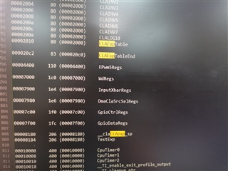

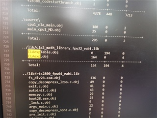

Steps for my customer to use CLA:
1. Include the lib library into the project;
2. Allocate memory for CLA.
LS0 : data
LS1~5 : program
3. include "CLAmath.h"
4. Programming in task. Call CLAexp, and the result is 0.
Another phenomenon is that when calling CLAexp, the keyword CLAexp is not highlighted.
