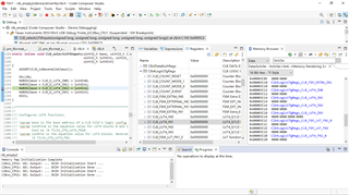

  • I found that the CLB registers are not being written correctly. And I can't write manually.
    Looks like CLB is not being configured in your case. Can you check if the clock is enabled to the CLB?

    I have tried other CLB examples.They all do not work properly.The reason is the same.The CLB registers are not being written correctly.I did not make any changes to these examples.This is very confusing to me.
    This is not expected behavior. Are even able to write to the CLB registers through the debug window?
    I can’t  write to the CLB register through the debug window. And I can write to other registers normally.
    It is worth mentioning that I am using a board designed by my company and not the LAUNCHXL-F280049C. is it possible that there is a circuit error causing this problem?
  • Hi, It seems like the CLB is not getting programmed for some reason. when you run the example code are the CLB registers being programmed?
    The CLB register can’t be programmed when I am running any CLB example code. By the way,this problem is on the board designed by my company. I can run well on LAUCHXL-280049C.

    1. Basic CLB examples (C:\ti\c2000\C2000Ware<version>driverlib\f28004x\examples\clb.  work on the LAUNCHXL but do not work on your custom board.
    2. The CPU doesn't seem to be able to write to CLB registers on the custom board.
    3. All other registers / functionality seems fine on the custom board.
    4. XCLKOUT looks correct on the custom board.
    My next suggestion would be to make sure the clock is enabled to the CLB. Item (1) indicates this is not the problem, though.  If it was, both boards would show the problem.
    I tried using an external crystal and replacing the emulator and computer. But none of them could solve the problem.
    By the way, I would like to correct a previous message. The demo board I am using is F280039C. the example used is also the F280039 example. But even so, I don't think the CLB example of F280049C could be a problem. Please confirm this for me if it's convenient, thanks!

  • Basic CLB examples (C:\ti\c2000\C2000Ware<version>driverlib\f28003x\examples\clb.  work on the TI board but do not work on your custom board.
    F28003x CLB example works well on TI board.
    F28004x CLB example has problem on custom board.
    (Because I don’t have a LAUNCHXL-F280049C. I used LAUNCHXL-F280039C instead of it. )
    The other points are correct.
    And here is a picture of the CLB register when running the example.

    Thank you for the information, it was very useful for me. I'm still trying to fix the CLB issue. Replacing the emulator didn't work. My colleague and I are trying to confirm if the chip might be damaged.
    Could you please explain the GEL address in detail? And I would like to know if the two-wire and four-wire modes of JTAG have any effect on CLB. Thank you very much!
  • Hi Sibo Chen,
    Are you certain the CLB base address is being passed into the call prior to the break point? Perhaps the problem is not occurring at the break point set it further back and remove any speed or register optimizations to zero. If that helps debug register stepping slowly increase optimizations for each compile time, clean the project run debug util the CLB registers appear to lose data again, AKA backtracking optimization bugs.
    The GEL file is part of the debug simulator register address access in CCS debug. XDS100 emulator control is slower even v3 but check the project build MCU target exactly matches the custom PCB MCU class. When you done did x39 XDS110 emulator did you change the project target XML file to match and set 2 wire JTAG is advanced properties? Perhaps 2 wire JTAG may be the only way to access CLB registers being a more advanced architecture. The x39 JTAG emulator 2 wire debug is more like SWD, not sure XDS100 can do 2 wire debug TWD, seemingly not.
    BTW you can view even edit the MCU class GEL file in debug under XDS tools or around that area. Been awhile since I been there done did that Nerd. Can also find several GEL files under CCS install path emulators or simulators folder.

    The reason why the CLB register cannot be written is found. Because the chip we purchased was damaged for some reason. After replacing it with a new one, the CLB register can be written normally, and the CLB example can work normally.

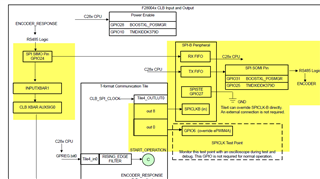

    I am debugging the latest F280049C example. I changed the SPIB in the example to SPIA.
    The program is not working properly on the custom board.
    When running without BOOSTXL-POSMGR on LAUNCHXL-280049C, the
    The clock signal and TxEn signal are shown in the figure. There is only a very short pulse when the program is just running. Is this normal?
    GPIO6(CLK)GPIO7(TxEn)
    I didn't find the information in desing guide.Could you please tell me how to modified the CLB output configuration if I want to use SPIA?
  • CLB output configuration if I want to use SPIA?
    Refer to the F28004x CLB Input/Output diagram.
    You will need to change the connections related to the SPI. For Tile4_OUTLUT0 --> SPICLKB, this may require a change in tile. The technical reference manual will show the detail for which tile can access which peripheral directly. The alternative is to route this signal to the SPI clock on your board instead.
    The configuration for routing and the CLB is done in the Library (CLB Tool) and in the example project's SysConfig.  The C2000 Academy has more information:
