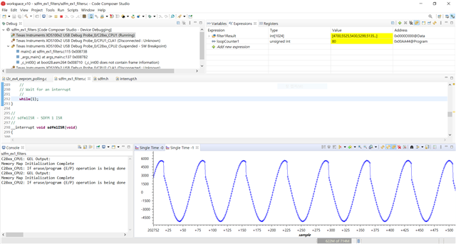

I found a error while using graph tool in CCS to see the data from SDFM adc result data in real-time.
This is the graph shows in ccs in real-time. it seems like some shifting happen periodically.
When I deacivate the "continuous refresh" button, then it shows like this.
So it seems like this error happens only in continuous refresh condition.
What is the cause of this problem, and Is there any solutions to solve this problem?
Thank you.

  • Hello Miles,
    Can you export the ADC results so I can take a look? You can do this while debugging by going to Tool → Save Memory and then follow the dialog prompts to save all the data at a given memory location. (If you are not already doing so, save the ADC data in an array that can be viewed in memory so we can see if there are any artifacts in the saved signal).

  • Hello Miles,
    To clarify, this data was obtained while you were viewing the graph in continuous refresh mode, correct? So it was updating the graph continuously until you paused to save the data?
    If the exported .dat file looks like it has an incorrect waveform when graphing with continuous refresh mode, you may need to use a secondary buffer to plot the graph. You are overwriting data continuously, so you may end up with strange looking data. If you use a secondary buffer, it should write all the data points from the primary buffer at once, instead of doing one at a time continuously.
    However, if you use continuous refresh for the graphing tool and your data still looks correct, let me know. The issue will likely be something else.
