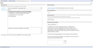

    I am not very familiar with UniFlash, so could we first try to debug this issue with Code Composer Studio (CCS)?
    At the top of CCS, select 'View' > ' Target Configurations'
    In the Target Configuration Menu, right click and select 'New Target Configuration', and name the file however you like.
    If you open the Target Configuration, you should see a menu like below. Make sure to select the correct options for your debugger and target device, like shown below.
    Once you have the target configuration file setup, you can use the 'Test Connection' button. That should test the connection from your computer to the debugger and from the debugger to the device. Depending on the log from that test, we may have more insight into what is going on. Please post that log here.
