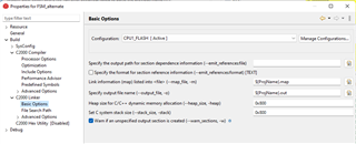

I am having a problem when I debug my program. When I run the program I get the following error:
It says there is no source available for _system_post_cint(). What is that?
The program counter is halted at address 0x3FE493 as shown here:
The address 0x3FE493 is part of the CPU1 to CPU2 MSGRAM according to the Memory Map shown here:
I have also updated the linker .cmd file because my program didn't fit in available memory. I have also increased the heap size from the default 0x400 to 0x800 and the stack size from the default 0x400 to 0x800 as shown here because I was getting warnings saying to increase them:
But my program has been crashing recently and I don't know why. I know which C function makes it crash. Actually, when I comment out a certain function, the program crashes. But if I leave that function in the code, it runs successfully. Did I corrupt something accidentally by adjusting the linker .cmd file? I am also using the Flash API to store variables to non-volatile memory. I really need some advice on this.
Here is my linker file:

- Matthew
  • Hi Matthew,
    Why do you have the peripheral RegsFile mapped to RAM memory. These contain actual peipheral registers and should be mapped to the corresponding perioheral memory space.
    You may use the F2837xD_Headers_nonBIOS_cpu1.cmd file from device_support/headers/cmd folder
    Veena

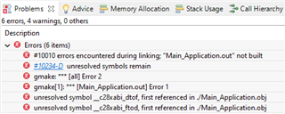

  • Thanks for your response.
    I excluded my .cmd file from build and added the one you suggested. But now I get several alarms! See below:
    - Matthew
  • Okay so I updated my original .cmd file with the RegsFile entries from F2837xD_Headers_nonBIOS_cpu1.cmd.
    My updated .cmd file is included below. Is there anything else I should adjust? Does it look correct now?

  • You can have 2 cmd files in one project. You can use the F2837xD_Headers_nonBIOS_cpu1.cmd as-is for all the peripheral registers, and the normal lnk cmd with RAM and Flash memories to allocate the code and data sections
    Please refer to the examples provided in C2000ware
    Veena
  • Ok thanks. I have included both cmd files in my project. The program runs, but when I step through the program after hitting a breakpoint It says "No source available for 'SysCtl_delay() at C:/Users\........'" as shown below:

  • Hi Matthew,
    That is okay, The function is written in assembly. You can view it through the disassembly window
    Veena
  • Thanks.
    After implementing your changes my code was running properly until I added the pow() function from math.h into my program. Now when I start the debugger and click run, I get this error:
    The program does not run. This is the same issue that was happening originally, but with a different function. But now, using the pow() function causes the program to crash. If I comment out the line where pow() is used, the program runs successfully.
    Please advise.
    - Matthew
  • This means your the core has reset, and is stuck somewhere in the BootROM code.
    Do you see this issue before reaching main, or while executing the pow function?
    Veena
  • I think I found the problem. I stepped through main() and I found that the program crashed when executing line 72 (which was not commented out at the time). I accidentally typed 200 for the clock frequency rather than 200 MHz! To fix this user error, I included device.h (which defines DEVICE_SYSCLK_FREQ) and adjusted line 71-72 as shown in the screenshot and the program stopped crashing.
    Why this issue only surfaced when using the pow() function is a mystery to me. Any thoughts?
    Thanks for your help. The solution is often simpler than it seems!
    - Matthew
  • Hi Matthew,
    I checked with the FlashAPI expert  and he mentioned the parameter should be in MHz. So 200 is the correct value to be used.
    Also I cant think of any reason why usage of pow() function is affecting FlashAPI function behavior
    Veena
  • Hi Veena,
    Thanks for your continued support. Unfortunately, I am still having issues.
    Here's a summary of my experiences:
    • With a frequency of 200 passed to Fapi_initializeAPI() my program crashes on that line, but if I comment out the pow() function which I'm using elsewhere, the program does not crash.
    • If I leave the pow() function in the program (uncommented) but a frequency of 200000000 passed to Fapi_initializeAPI() the program runs, but the Flash is not written!
    • Similarly, if I use a frequency of 200000000 in Fapi_initializeAPI() with pow() commented, the flash does not write.
    • If I use 200 as a frequency and comment out the pow() function the program runs and Flash writes successfully. What's going on?
    I don't understand why the pow() function would have an effect on the Flash API. I need to use both in my program, so I hope we can find a permanent solution. Are there any known bugs with math.h or pow() that I might be introducing to my program inadvertently? Could this still be a linker command file issue?
    Thank you for your help, and I am looking forward to resolving this,
    - Matthew
  • Hi Matthew,
    The only correlation I can think of is, while using pow() function, there could be additional set of functions are constants that would be allocated to Flash. By any chance is it getting allocated to the same sector where FAPI is writing to?
    I believe you are running Flash API functions from RAM?
    Veena
  • Hi Veena,
    I am writing to sector H in Flash. How can I tell where those constants are being allocated? Is there a way to protect a certain sector from being used by anything other than the Flash API?
    I believe I am running Flash API functions from RAM, but how can I be sure that all the API functions are executing from RAM? I precede all my user-defined functions with

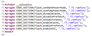

    #pragma CODE_SECTION(function_name, ".TI.ramfunc");
    I understand that the linker command file puts all the input sections named .TI.ramfunc into RAM, and using the #pragma statement above assigns functions to the .TI.ramfunc section. I see in flash.h that some functions are assigned to .TI.ramfunc as shown here:
    But I see that most functions in flash.h do not have a #pragma statement before them, such as this function:
    Should those functions also have the #pragma statement before them? How can I know if these functions are getting moved to RAM? Also there are Flash API functions in F021.h for which I cannot find the source file to see if there is a #pragma statement. How can I know if those functions are getting moved to RAM? I think their source file is part of F021_API_F2837xD_FPU32_EABI.lib which is not human readable.
    - Matthew
  • I also discovered something else.
    I added the #pragma statement before the function that calls the pow() function as shown below.
    Now, calculate_duty() (the only function that calls pow() ) is executed from RAM, and the program runs without crashing and the Flash writes successfully. Any thoughts?
    - Matthew
  • Hi Matthew,
    You may need to place the entire FAPI library in RAM. You can do it using this command in linker cmd file -
    (change the memory blocks as needed)
            GROUP
                .TI.ramfunc
                { -l F021_API_F2837xD_FPU32.lib}
            } LOAD = FLASHD,
              RUN  = RAMLS03,
              LOAD_START(_RamfuncsLoadStart),
              LOAD_SIZE(_RamfuncsLoadSize),
              LOAD_END(_RamfuncsLoadEnd),
              RUN_START(_RamfuncsRunStart),
              RUN_SIZE(_RamfuncsRunSize),
              RUN_END(_RamfuncsRunEnd),
              PAGE = 0
    In case of Flash driver, those specific functions that need to be run from RAM is placed in ramfunc section using the pragma
    Veena
  • Hi Veena,
    I found another issue with my linker cmd file that I think was causing the problem. I had the following line in my SECTIONS directive:
    .text               : >> FLASHB | FLASHC | FLASHD | FLASHE      PAGE = 0, ALIGN(8)
    Notice that I am using the double arrow ">>" operator to split the .text section across Flash sectors B-E. The reason the Flash API functions were causing the PC to jump to an illegal address is because the Flash API functions are loaded into FLASHD and then run from RAM as shown here:
    .TI.ramfunc : {} LOAD = FLASHD,
                     RUN = RAMLS0,
                     LOAD_START(RamfuncsLoadStart),
                     LOAD_SIZE(RamfuncsLoadSize),
                     LOAD_END(RamfuncsLoadEnd),
                     RUN_START(RamfuncsRunStart),
                     RUN_SIZE(RamfuncsRunSize),
                     RUN_END(RamfuncsRunEnd),
                     PAGE = 0, ALIGN(8)
    Because .text was also using FLASHD, when FLASHD was copied to RAM the .text section became corrupted because its contents were shared across Flash sections.
    I removed FLASHD from the .text section as shown below and my program has been running smoothly since.
    .text               : >> FLASHB | FLASHC | FLASHE      PAGE = 0, ALIGN(8)
    I will let you know if the problem returns.
    Thanks again,
    - Matthew

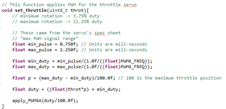

  • Hello all,
    Unfortunately, the problem has returned. I added the following code:
    Note, I've had that function in my program for a couple months, but I just changed the equation and added all the floats today and that's when the problem came back.
    I'm getting this error when I try to run my program in debug mode:
    I'm getting frustrated that this problem keeps returning.
    I hope we can get to the bottom of this.
    - Matthew
  • It seems like the device has reset. Can you step through the code and check which line actually caused the reset?
    I hope float_support is set to fpu32 under compiler settings
    Veena

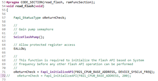

  • Hi Veena,
    When I step through the code, it crashes on line 86:
    Seems like trouble with the Flash API again.
    Also float_support was set to fpu64, and when I changed it to fpu32 I got more errors as shown below:
    I'm not sure what those errors mean, so I reverted back to fpu64.
    I took your advice by moving the entire FAPI library into RAM, and my program runs! But I just have this warning now:
    - Matthew
  • Update, I added the following after GROUP and the warning went away:
    FLASHIJ is my combination of FLASHI and FLASHJ into one big sector.
    Just remember to assign the GROUP to Flash memory. I tried using RAM here, but it caused the program to crash after a power cycle because RAM is volatile. I changed it from RAM to Flash and now it runs correctly.
    - Matthew
  • Hi Matthew,
    Ramfuncs is meant to be run from RAM. The correct setting is as follows -
    GROUP
    .TI.ramfunc
    { -l FAPI_F28003x_EABI_v1.58.10.lib}
    } LOAD = FLASH_BANK0_SEC1,
    RUN = RAMLS03,
    ALIGN(8)
    And use those symbols to perform the copy from FLASH to RAM. Alternatively,
    GROUP
    .TI.ramfunc
    RUN = RAMLS03,
    TABLE(BINIT),
    ALIGN(8)
    With BINIT, the copy is handled by the boot code itself.
    Veena
