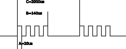

I need to generate PWM in chanel 2 and 3 as shown in Figure.
I am setting PWM frequency to 20 us .PWMa and PWM b need to be complementary The B and C timing is made using timer module as in code.
There are two problems.
a. When I am disabling the PWM, I need both A and B channel to pull low. However this is not happening.
b. Is there a better way to implement the above logic.

  • Hi Sachin,
    When you mean disabling PWM, do you mean completely turning off the PWM channel (i.e. setting TBCLKSYNC = 0)?
    When would you want to set all the outputs low, is there an external signal or a certain counter to generate these events?
    Your TBCLK is set to 60 MHz correct?
    For A,B,C within your diagram, are those Channel's 1, 2, 3 respectively?
    - Right now it looks like channel 1 is set to 20 us, channel 2 is 140 us, channel 3 is 2000us for their PWM frequency.
    Here is another e2e thread that may be of help.
    Another solution would be having a One Shot trip event to occur. This one shot could be generated using GPIO 12,13,14 and having the trip-zone selected to be enabled. Then in the Trip Zone (TZCTL) you can force epwmxA or epwmxB to output low or high depending on your configurations. There does exist a one shot trip example within the device_support/f2802x\examples\drivers\epwm_trip_zone folder as reference.
    Ryan Ma
  • Thanks Ryan Ma for the reply.
    I mean to disable PWM (make appropriate logic)  to generate the waveform in channels (PWM2, PWM3) as shown in the figure. By disabling, I mean both A, B of Channel 2,3  should be low.
    The timing mentioned in the figure is all for a given PWM channel (say 2,3) (being set in complementary mode).
    Its not Channel 1=20us, Channel 2=140us  and Channel 3=2000us
    PWM should be set with high frequency (say 50Khz) in complementary mode. Then it should be disabled/enabled (or any other better logic) to obtain duration when pulses are ON as say 140us and when duration, when there are No Pulses, is around 2000us or more.
  • Hi Sachin,
    For the logic to turn off your PWM signals:
    Have you tried setting a One Shot software force trip event to occur when you want to turn off your PWM signals? You can then clear this trip event flag when you want to start the PWM pulse again.
    Looking over your code, it seems you want to stop the PWM pulse when this logic is met:
    (count_discharge_duty>=DISCHARGE_DUTY && count_discharge_period<DISCHARGE_PERIOD)
    1. You can set a software one shot trip zone event flag within here, which would set the PWM outputs to low.
    2. Then when you want to start your PWM outputs again, you can clear this one shot trip zone flag and the outputs will start again.
    Ryan Ma

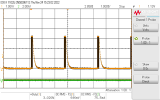

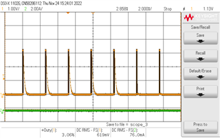

  • Thanks Ryan for the reply.
    I have used software based trip zone (one shot) and its working . However, sometimes the PWM decays exponentially . What could be the issue.
  • Hi Sachin,
    Is this occurring frequently? If you can send me your project either privately or on here, I could take a look further as to why this may be happening.
    One more thing I noticed in your code is during the interrupt you are setting AQ events.
    What happens if you comment those lines out for now and test it? I think you have initialized the AQCTL values in your initialization of PWM signal.
    I would not suggest changing AQCTL on the fly since this is occurring during an interrupt and that may be the cause of what you are seeing.
    Ryan Ma
